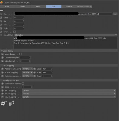

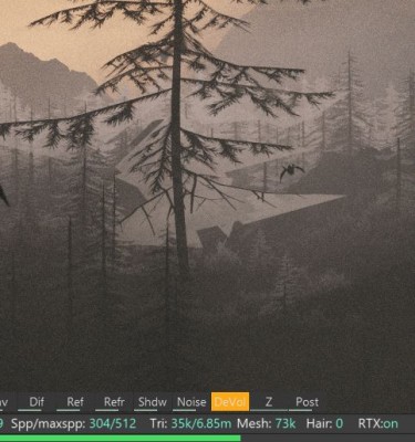

checked - it's visible only in Volume channel - took one tree closer:
VDB settings:

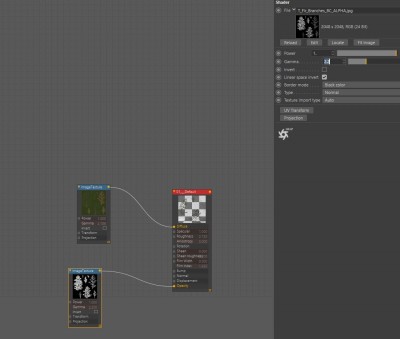

Tree shader - straight forward ... they are scattered x25000 ;)

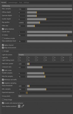

Octane settings:

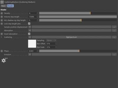

Found a tweak and it looks ok!
Changed Volume Step lenght in Scattering Medium in VDB settings to ~1.5 instead of 15000 ;] ..
TOPIC - SOLVED.
