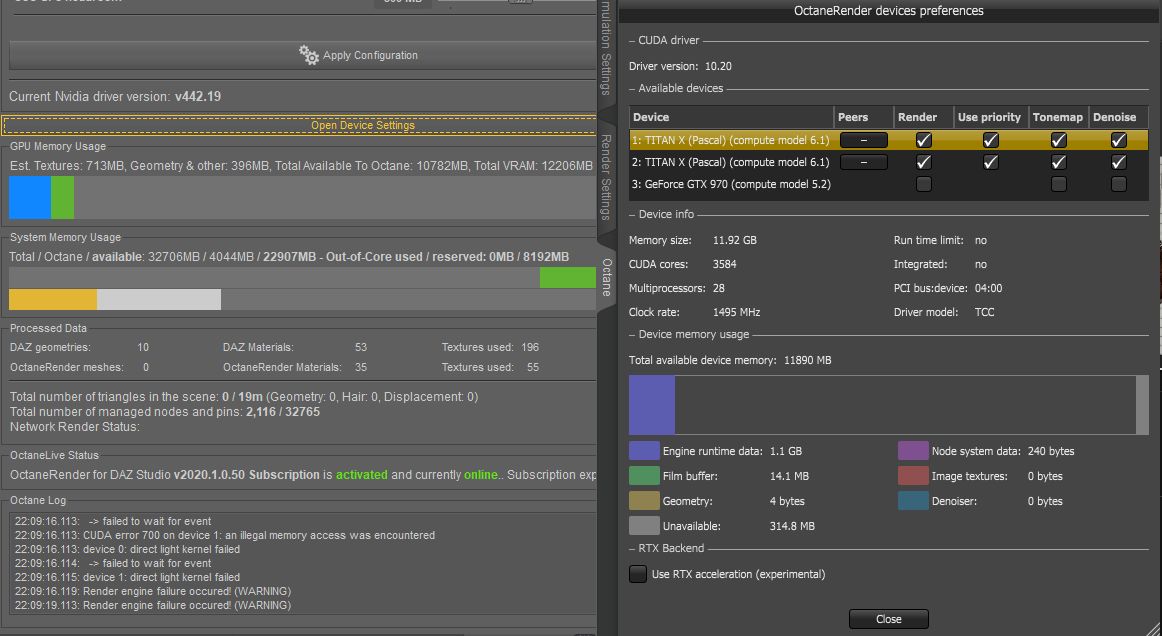

I am using the 2020.1.0.50 Enterprise plugin for Daz3D and just tried rendering a scene that was created and rendered fine yesterday, but today cannot get beyond the "Building geometry" stage.
This scene was a test involving water and caustics and was based on another scene which still renders without real problems in the same level of Octane plugin (sometimes requiring the Pause -> Continue toggle to work the first time, though).
Here's the log when this newer scene is loaded and I try to open the Octane Viewport:
Code: Select all
22:08:12.926: +++++ Plugin running.
22:09:16.113: CUDA error 700 on device 0: an illegal memory access was encountered
22:09:16.113:   -> failed to wait for event
22:09:16.113: CUDA error 700 on device 1: an illegal memory access was encountered
22:09:16.113: device 0: direct light kernel failed
22:09:16.114:   -> failed to wait for event
22:09:16.115: device 1: direct light kernel failed
22:09:16.119: Render engine failure occured! (WARNING)
22:09:19.113: Render engine failure occured! (WARNING)
Here are my System settings:
Ideas welcome.

Suggest rebooting and trying again.

Thanks, I have tried that a few times with no better effect.
It seems that ONLY this newer file is having this problem: the earlier versions of this same scene exhibit none of those System errors when opening the Viewport. But, as soon as I try with this newer scene, then the errors occur.
I suggest exporting that scene to ORBX and seeing if the error occurs in Octane Standalone. If it does - report it to OTOY in the Octane Standalone 2020.1 release thread.

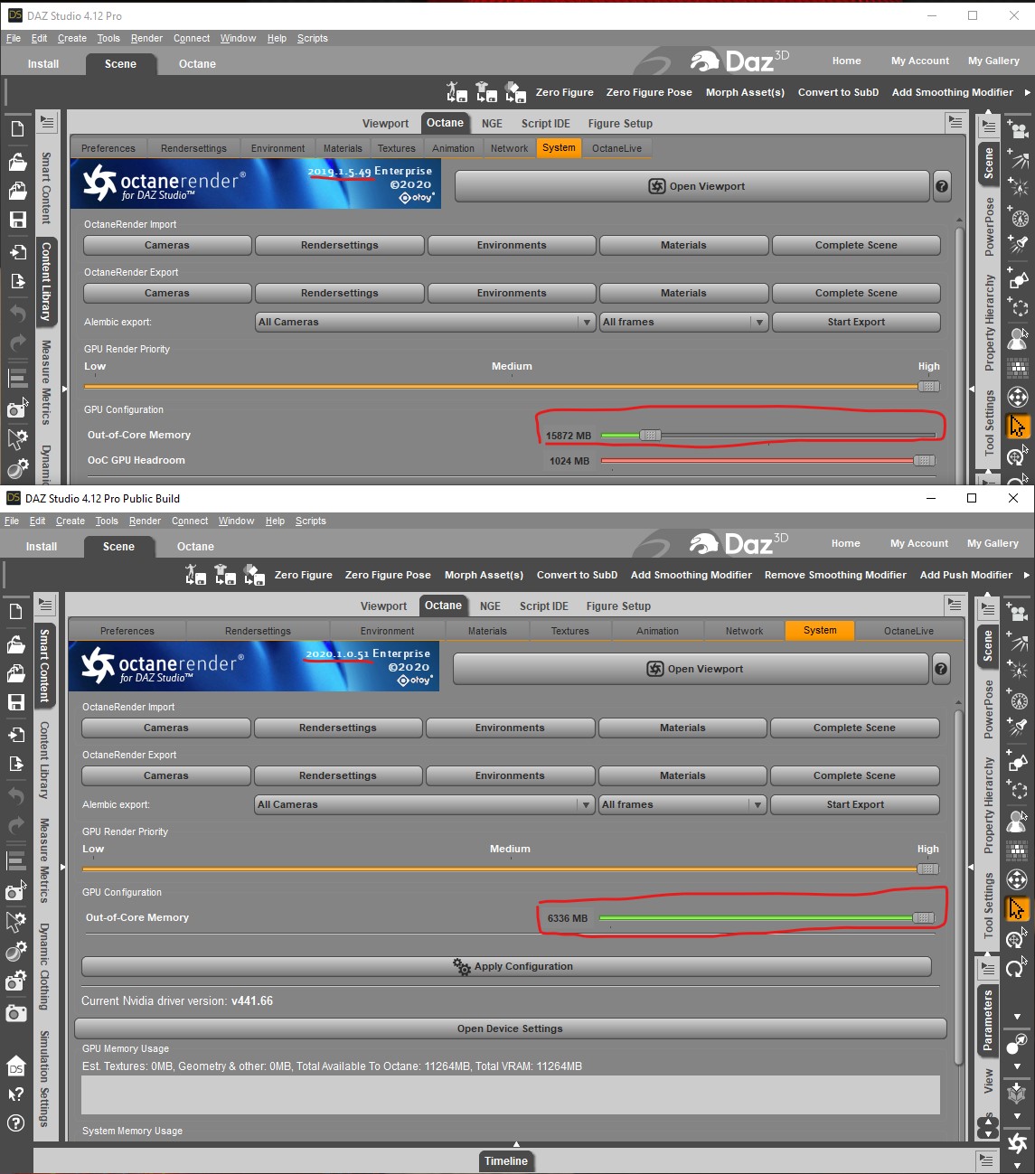

Having issues Paul. Every scene of mine crashes as soon as I hit Render. Even the ones which have no issue rendering under 2020.1.XB3, 2019.1. 5.49 and earlier.
Also why is the OOC Memory slider restricted to 6336MB ? I have 128GB of RAM and I should be able to set it to any size within my Total System Memory. You can see my earlier post regarding the test I did with the Stand Alone version and I had selected 50+ GB of RAM as OOC Memory in the Stand Alone. I switched back to 201.1.5.49 and there I can set the slider to any size up to my system memory size of 128GB. Please check this. Maybe my crashes are related to this.

Hi Paul,
Here's a screen shot of the issue. I have 2 copies of Daz. One with 2019.1.5.49 and the other with 2020.1.RC1. I ran both together to show the issue with the OOC memory size slider selector. As you can see in 2019.1.5.49 I set it to around 15GB and I can still drag the slider a lot to the right to allocate even more. But under the 2020.1.0.51 (RC1) the slider is already max out at 6336MB.
2019.1.5.49 / 2020.1.9.51 (RC1) OOC memory setting difference.
I did reboot just to see if it was just an initial installation issue. But the issue persists after the reboot.
Hope you can fix this ASAP.
