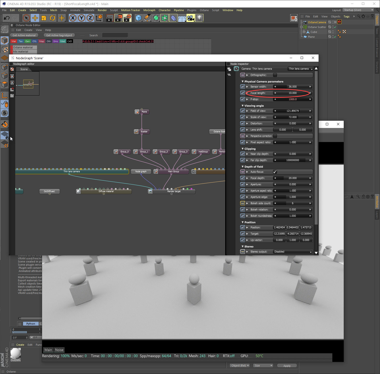

I just did a quickie test, and see similar results. I'm guessing it's the other end of this issue:
viewtopic.php?f=9&t=73958&p=377807#p377807
So apparently Octane has a 10-1200 Focal Length range limit. Based on the previous thread, it's an SDK problem, not a Plugin problem.

- ShortFocalLength.c4d.zip
- Camera Focal Length < 10 = Unhappy
- (62.55 KiB) Downloaded 331 times
Yes, it seems like limited in 10-1200. It can be seen from octanerender interface. So this is not a bug, limitation.frankmci wrote:I just did a quickie test, and see similar results. I'm guessing it's the other end of this issue:

the issue should have been fixed in 2020.1-RC2 SDK, could you try with that version, and report back?
- Fixed slider and value bounds on the "fov" and "focal length" camera nodes.
Worked just fine for me in 2020.1 RC2.
Downloaded the example file frankmci posted and it rendered correctly.
