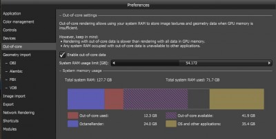

I tested a scene that always gave a memory error with OOC in the both the plugin and standalone with 2018.x / 2019.x and 2020.x up to XB3 and it finally rendered in the Standalone 2020.1 RC1 :) ! So whatever they did this time to the OOC code seems to have fixed the issue. Looking forward to the plugin release now. Many many scenes to render that I have not been able to render for a long while.
2020.1 RC1 Standalone with OOC memory being used
