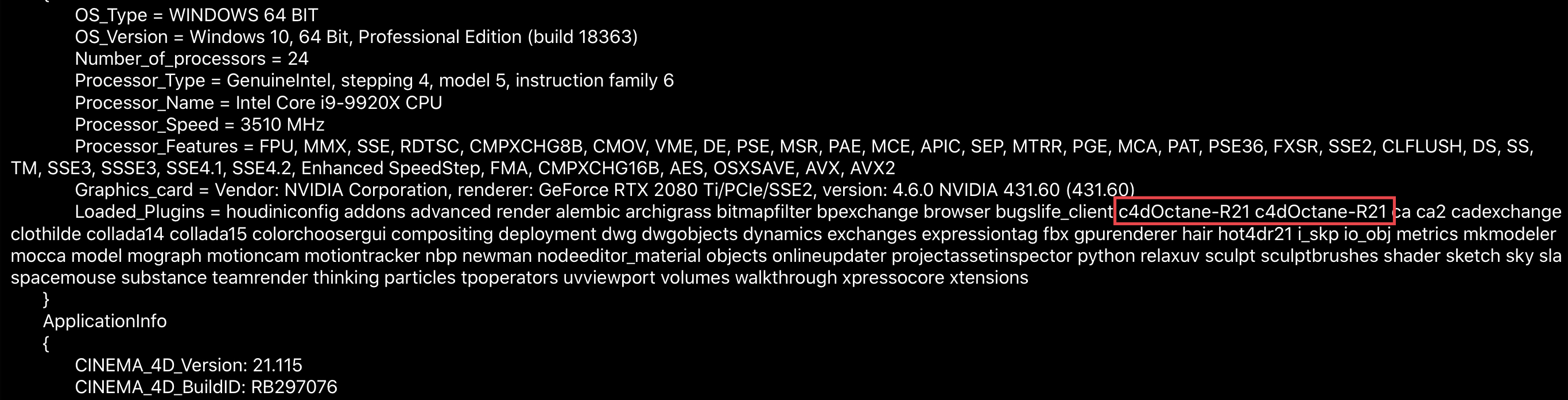

the bugreport shows that c4doctane is installed twice in R21:
Please remove one of the c4doctane folder, then go to c4d menu Extensions/Console, (Shift+F10), and share a complete screenshot of the panel, thanks.
Please, also share a screenshot like this one:
