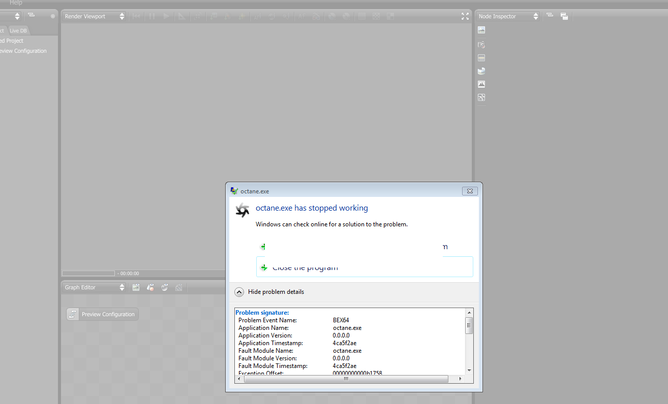

could it be that my octane install is corrupt or im using false drivers?
but why would it crash after click on import mesh immediately?

tetrochuan wrote:could it be that my octane install is corrupt or im using false drivers?
That sounds like a driver problem. Which hardware and which driver are you using?

after reinstalling octane, cuda and display drivers still wont work?!
what else could be the problem here?

tetrochuan wrote:after reinstalling octane, cuda and display drivers still wont work?!
nice model, runs smoothly, so the c4d scene is ok, your software is not, I have the 258.96 nvidia drivers, so check that and the cuda drivers
