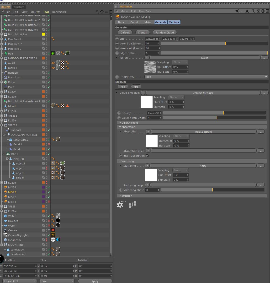

But I ran into an issue with Volumes.

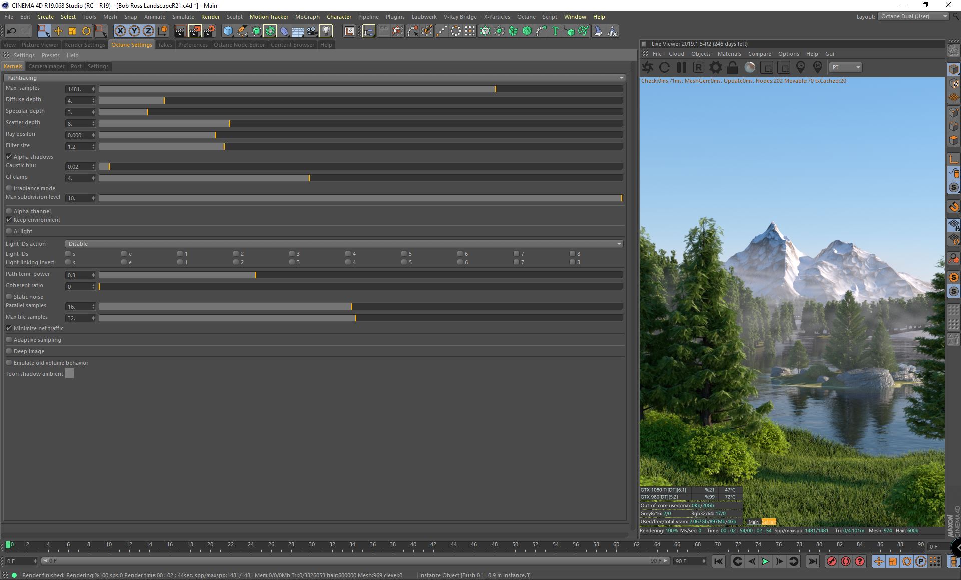

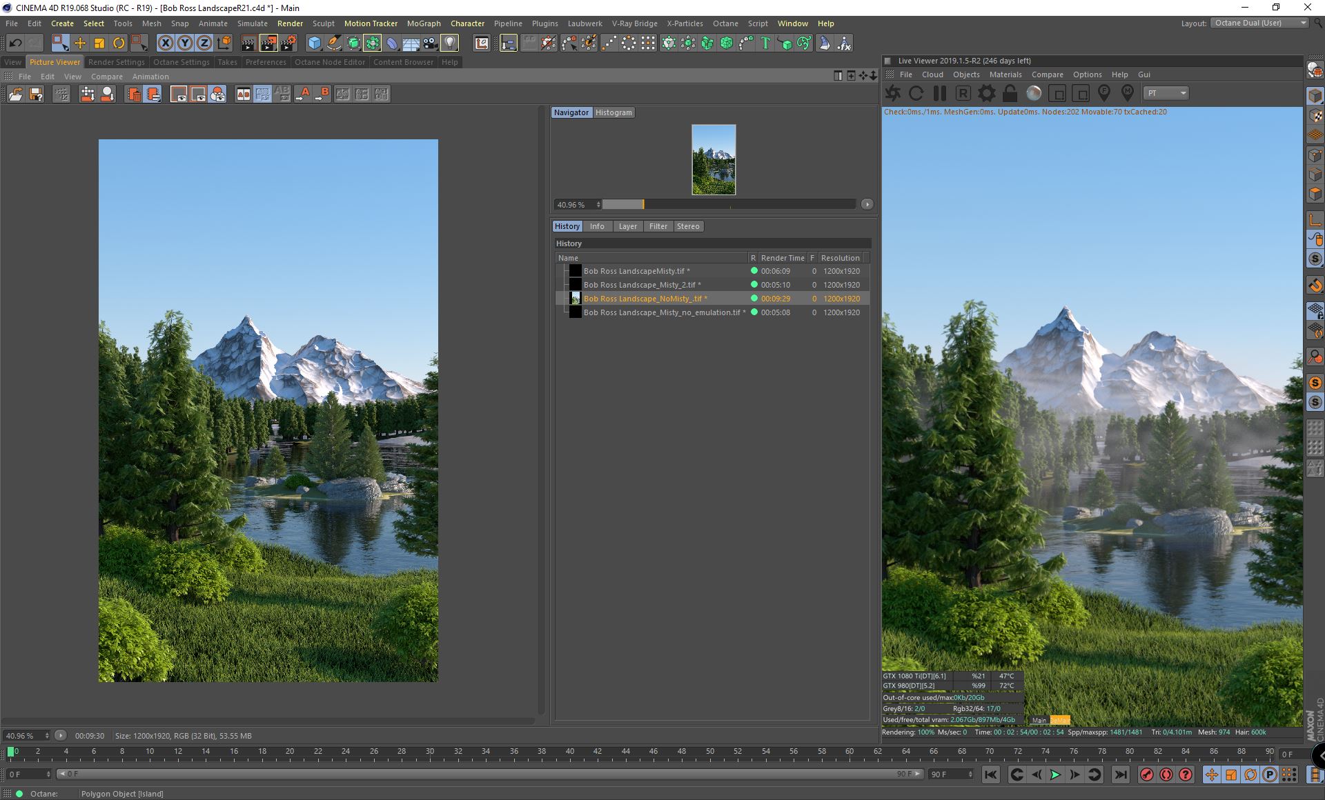

Can anyone shed some light on why I can't get volumes rendered using the Picture Viewer?
It either crashes with an out of memory error or renders for 5-6mins and produces a black image.
According to the info stats on the Live Viewer it's not running out of memory or using out-of-core memory.
I've tried with both 'Emulate old volume behavior' on and off - no difference.
It renders fine with the Volumes turned off.
Any thoughts?
