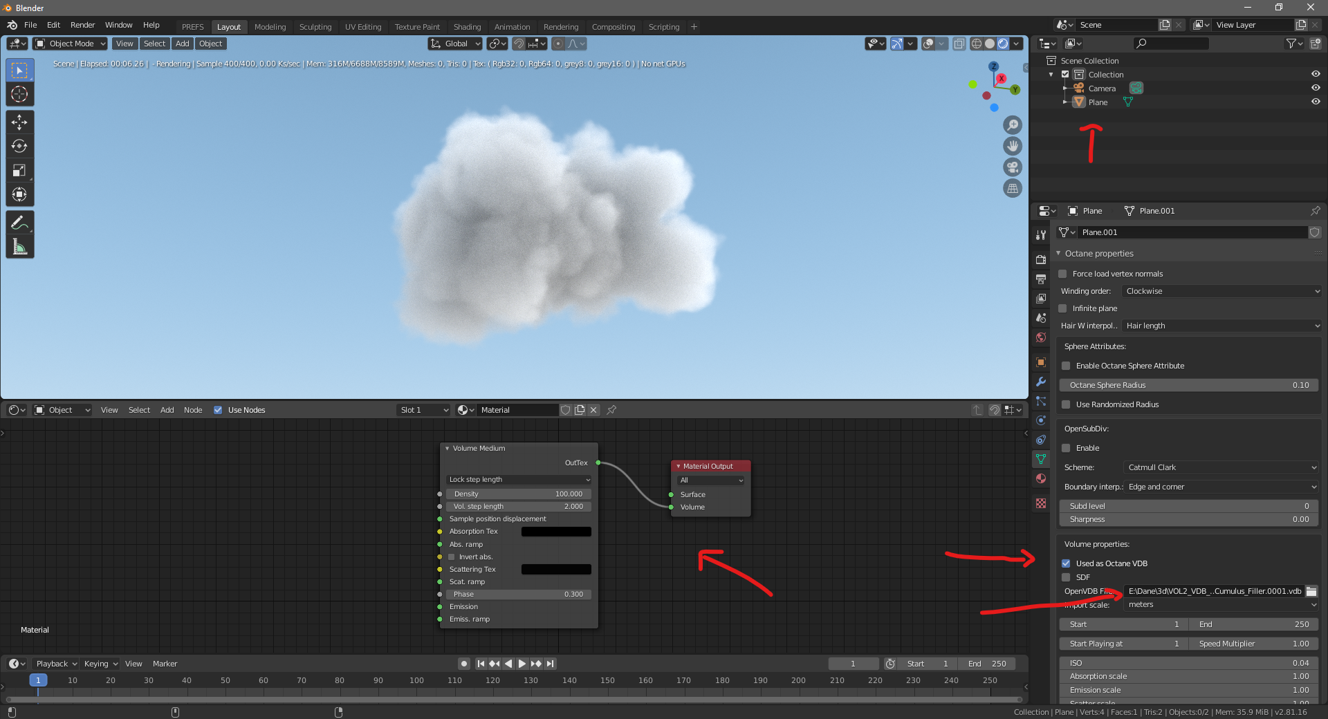

BTW...what are VDB files? Something to do with Houdini? Wonder how it is related to Blender then (o;

davorin wrote:Evening (o;
Anyway....gonna subscribe for a month now tomorrow (already late evening here ;o) and see how it performs compared to E_Cycles RTX 2020....
You nee to have VDB files created in other software like Houdini or Spectron. To use them in Octane you need to create a simple object eg plane and in Octane properties you need to attach a VDB file to it. Toggle "Use as Octane VDB" and setup a Volume material to it:

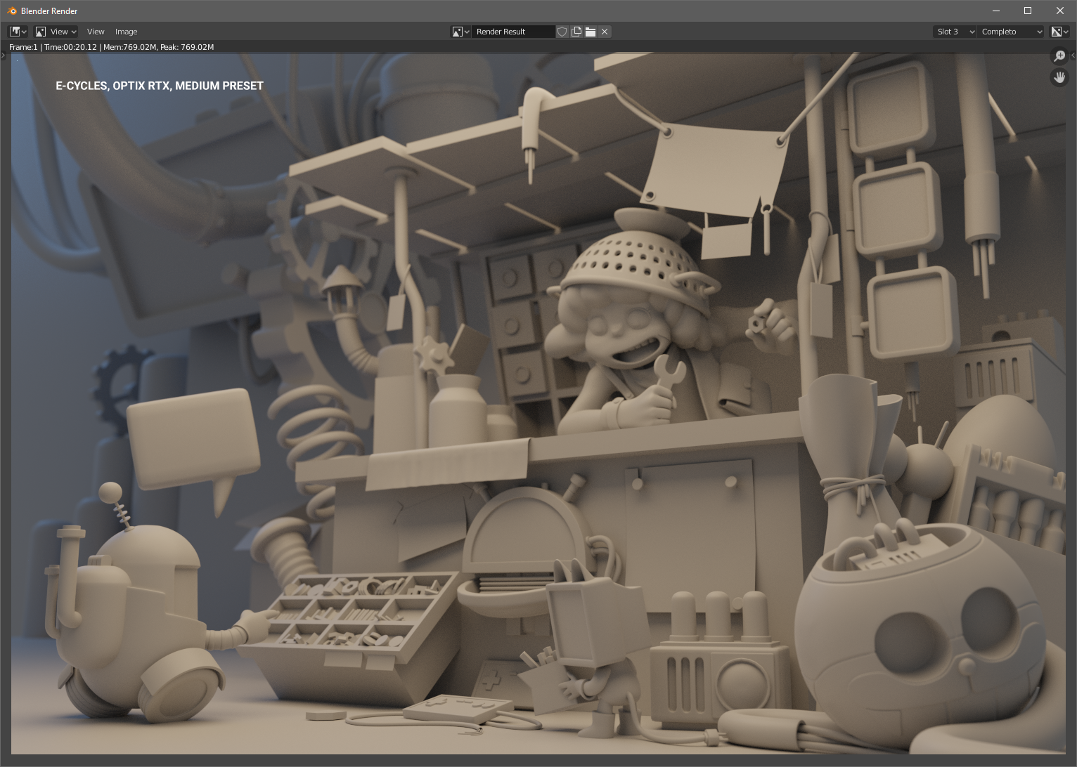

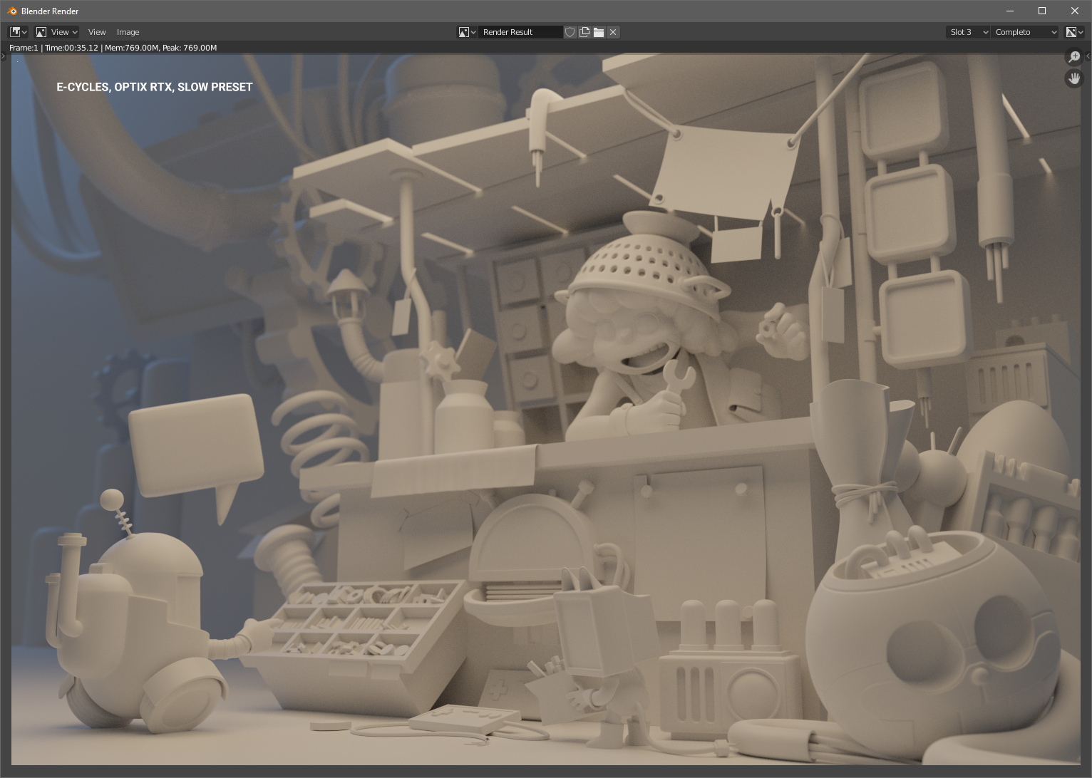

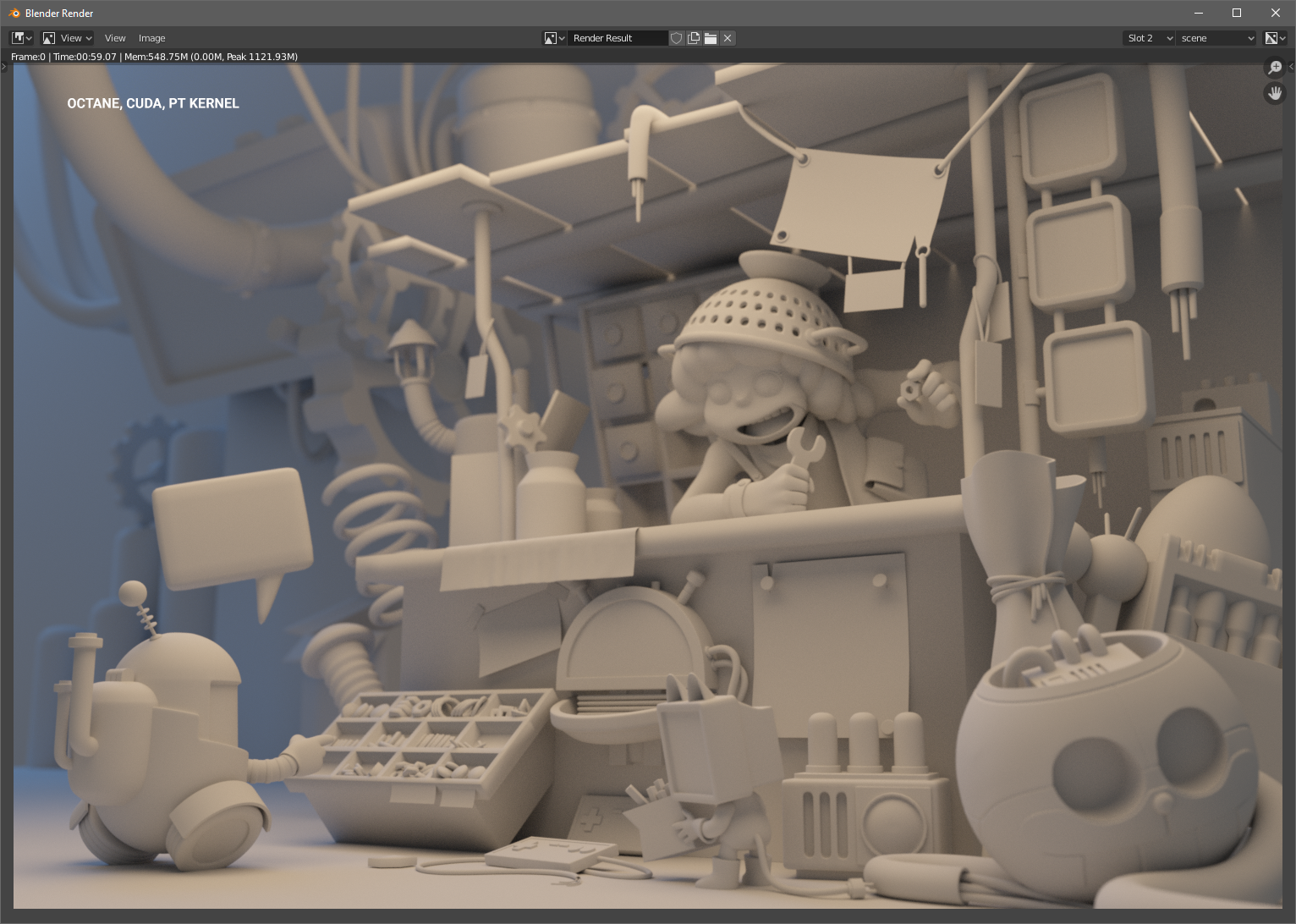

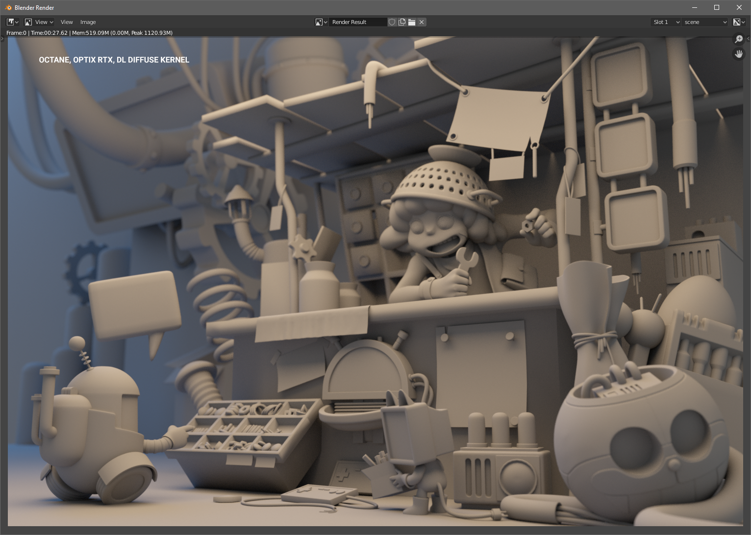

In a scene I tested E-cycles is 10-15% faster than Octane.
Official Cycles Blender build is almost two times slower compared to the fastest e-cycles – 59 sec. vs 35 sec.
Blender 2.82, Cycles, OPTIX RTX, 58 sec:
E-Cycles, CUDA, 1:36 sec:
E-Cycles, OPTIX RTX, Medium Preset, 20 sec.:
E-Cycles, OPTIX RTX, Slow Preset, 35 sec.:
Octane, PT kernel, CUDA, 59 sec.:
Octane, Direct light kernel, OPTIX RTX, 27 sec.:
