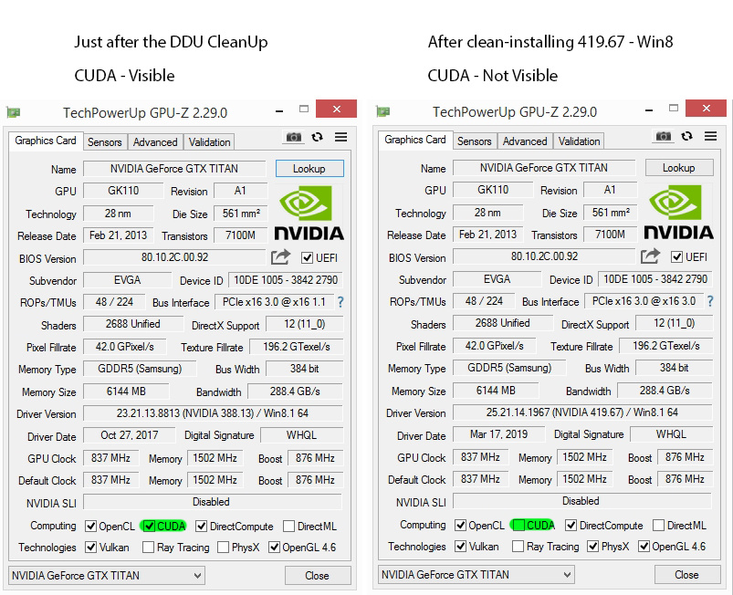

Hello Beppe,
Thank you for the instructions,
1. I installed windows 8 version of 419.67 since my OS is W8.1
2. I performed a clean installation
3. I still see the same error in Octane 4.05
This is my GPU-Z screenshot. I see that CUDA is not marked after 419.67. ( please note that just after the DDU, I was able to see CUDA ).
Posts: 10575
please try to perform a clean installation of 442.19 driver:

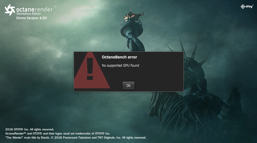

Hello
I clean-installed 442.19 for Windows 8.1
I ran OctaneBench_4_00c / octane.exe and received this message: No supported GPU found
Posts: 10575
Is CUDA still unchecked in the GPU-Z panel?
You need to find an Nvidia driver greater than 419.67 that works for you.
Unfortunately I don’t have other reports from Win 8.1 users, normally it is Win 7 or Win 10. :roll:
