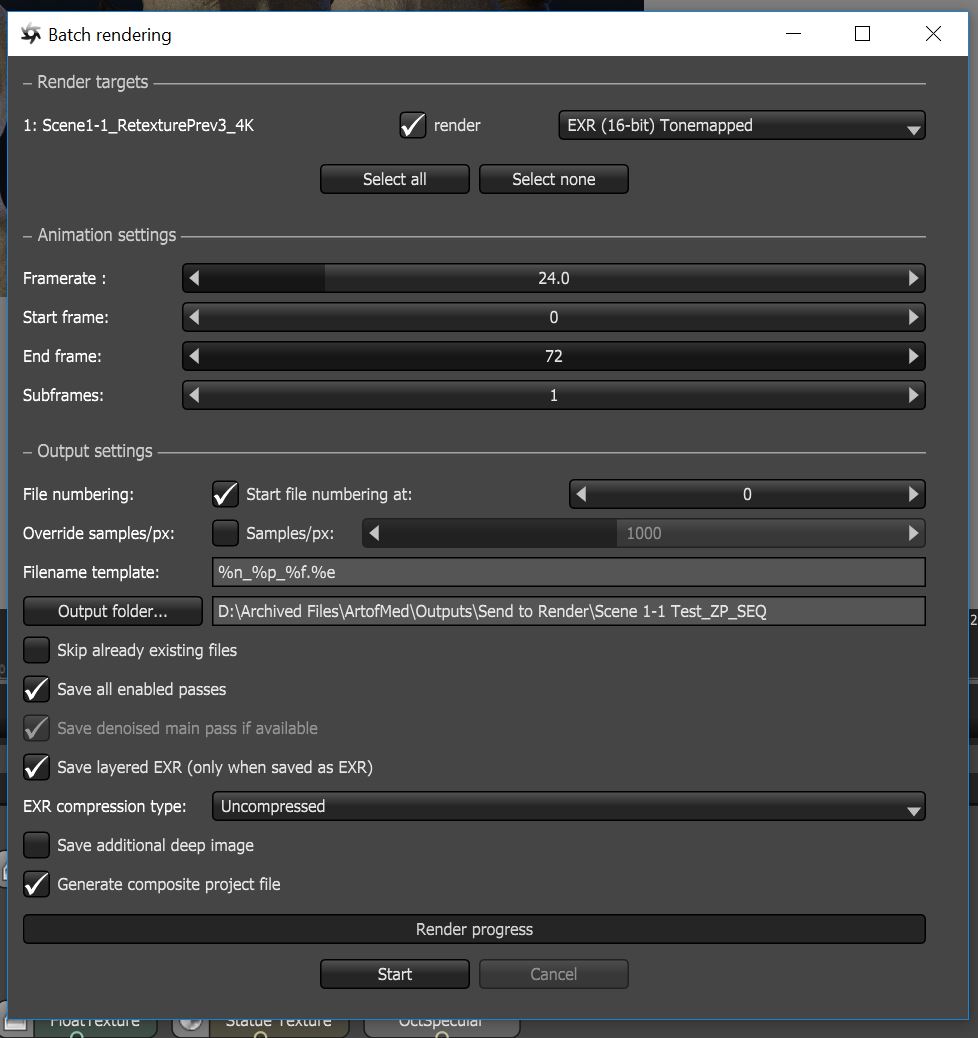

Postby jekris » Fri Feb 07, 2020 4:10 pm
jekris Fri Feb 07, 2020 4:10 pm
Thanks for the reply!
I did batch rendering already and it did not look like the picture from the documentation in your link. I checked the save all enabled passes but when I finished rendering it only rendered the beauty pass. I am running Octane 2019 Stand alone. I attached here a pic of what the batch rendering module looks like on my end and the settings I used. Thanks for your help!
jekris
Posts: 2
Joined: Thu Feb 06, 2020 9:49 pm

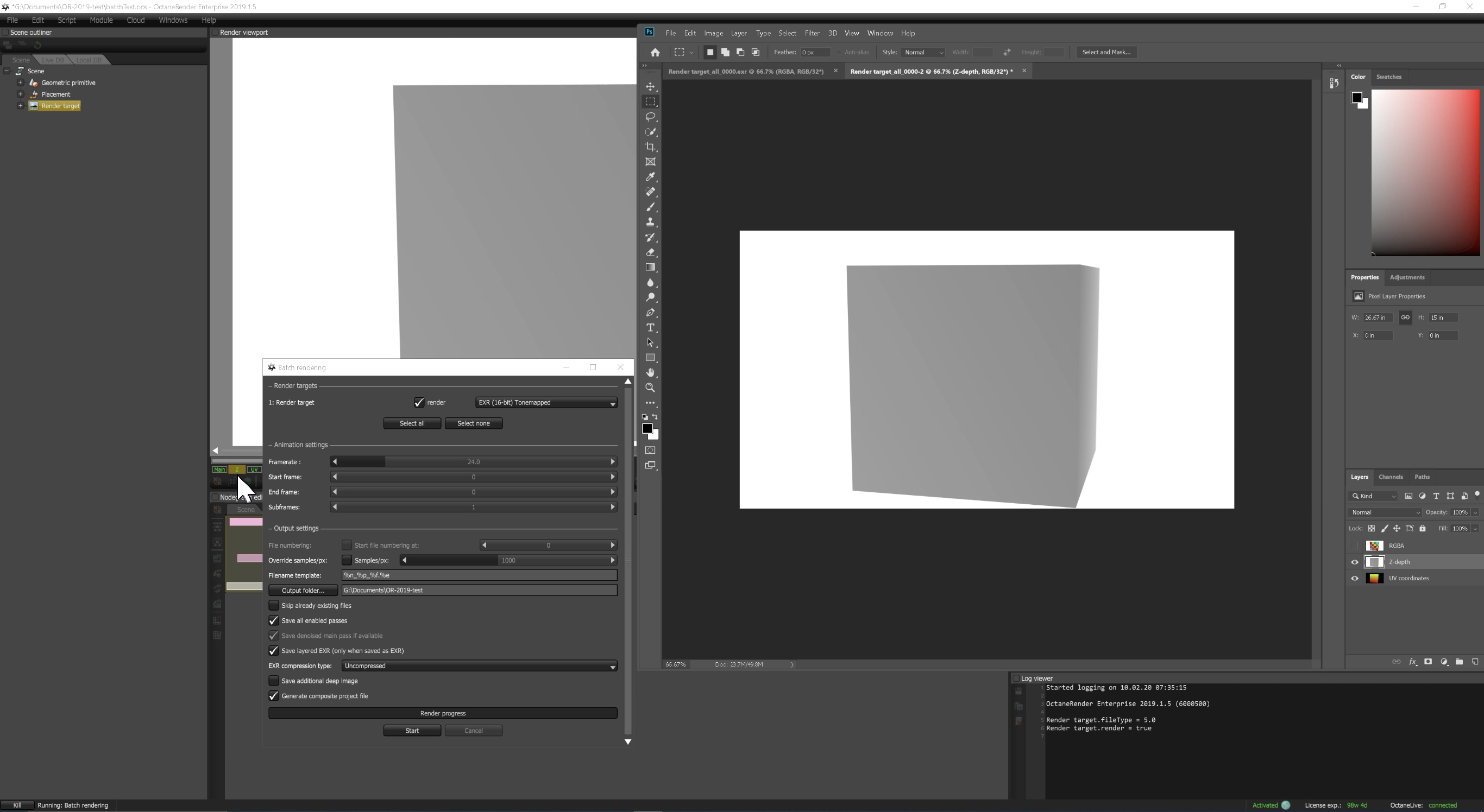

Postby bepeg4d » Mon Feb 10, 2020 6:49 am
bepeg4d Mon Feb 10, 2020 6:49 am
weird, it seems to work as expected in 2019.1.5 here:
ciao Beppe
