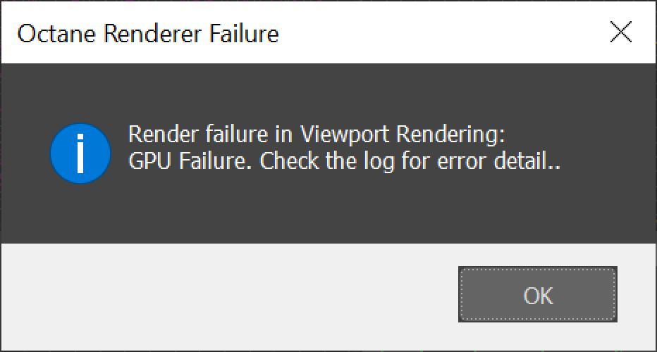

I also get that error often:
- Attachments
- Render Failure
- error.png (10.88 KiB) Viewed 6607 times

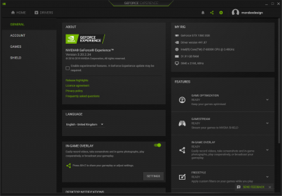

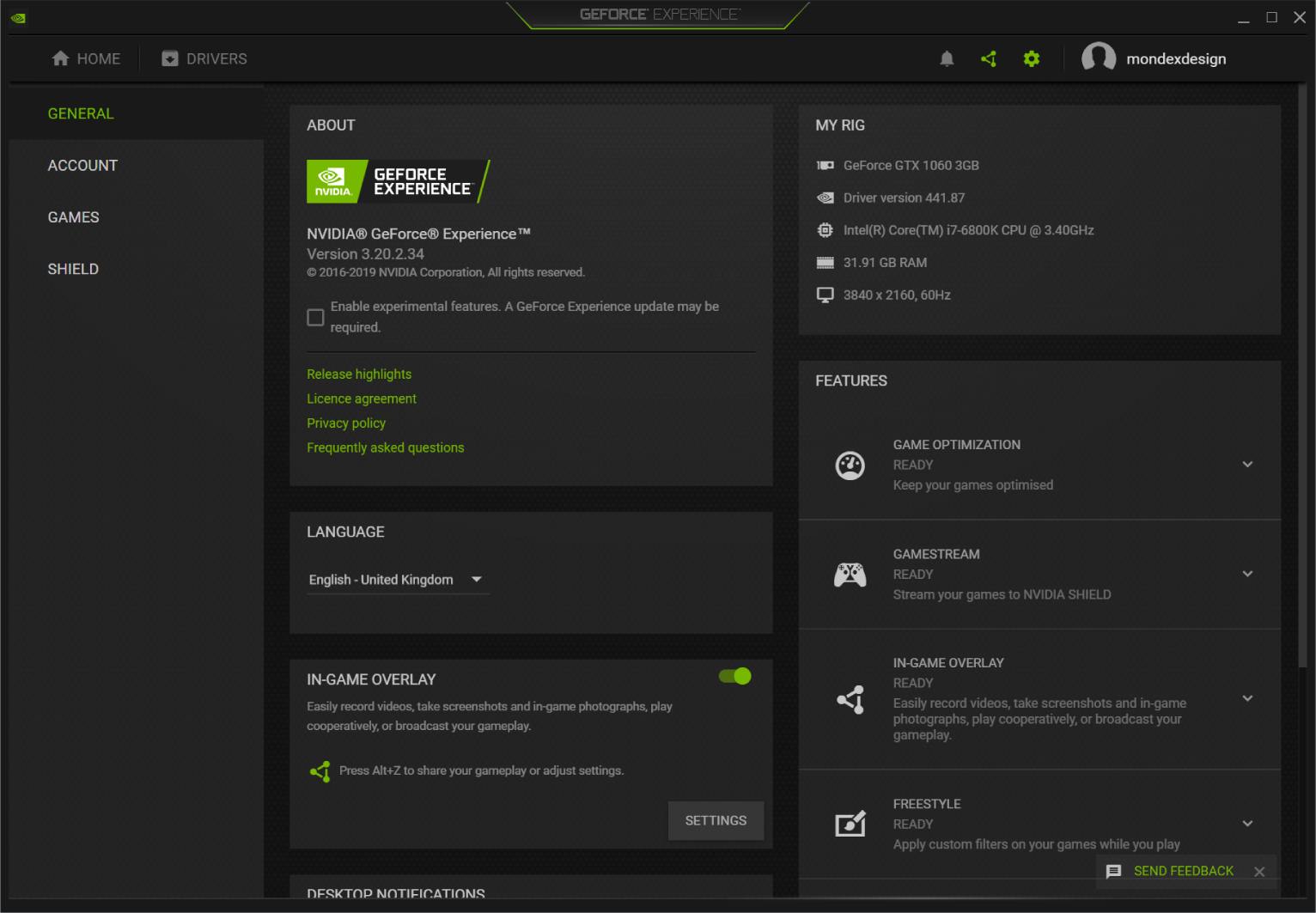

Hi Mondexdesign,Mondexdesign wrote:Thanks!
My PSU is 450W. Here's a screenshot of my GPU info.
your GPUs has 3GB on board and Windows 10 eats 600MB + monitor etc.
You would necessarily to use Out-of-core option and install Nvidia driver 441.66 (studio) and not DHC but standard.
https://www.nvidia.com/download/driverR ... 5646/en-us
