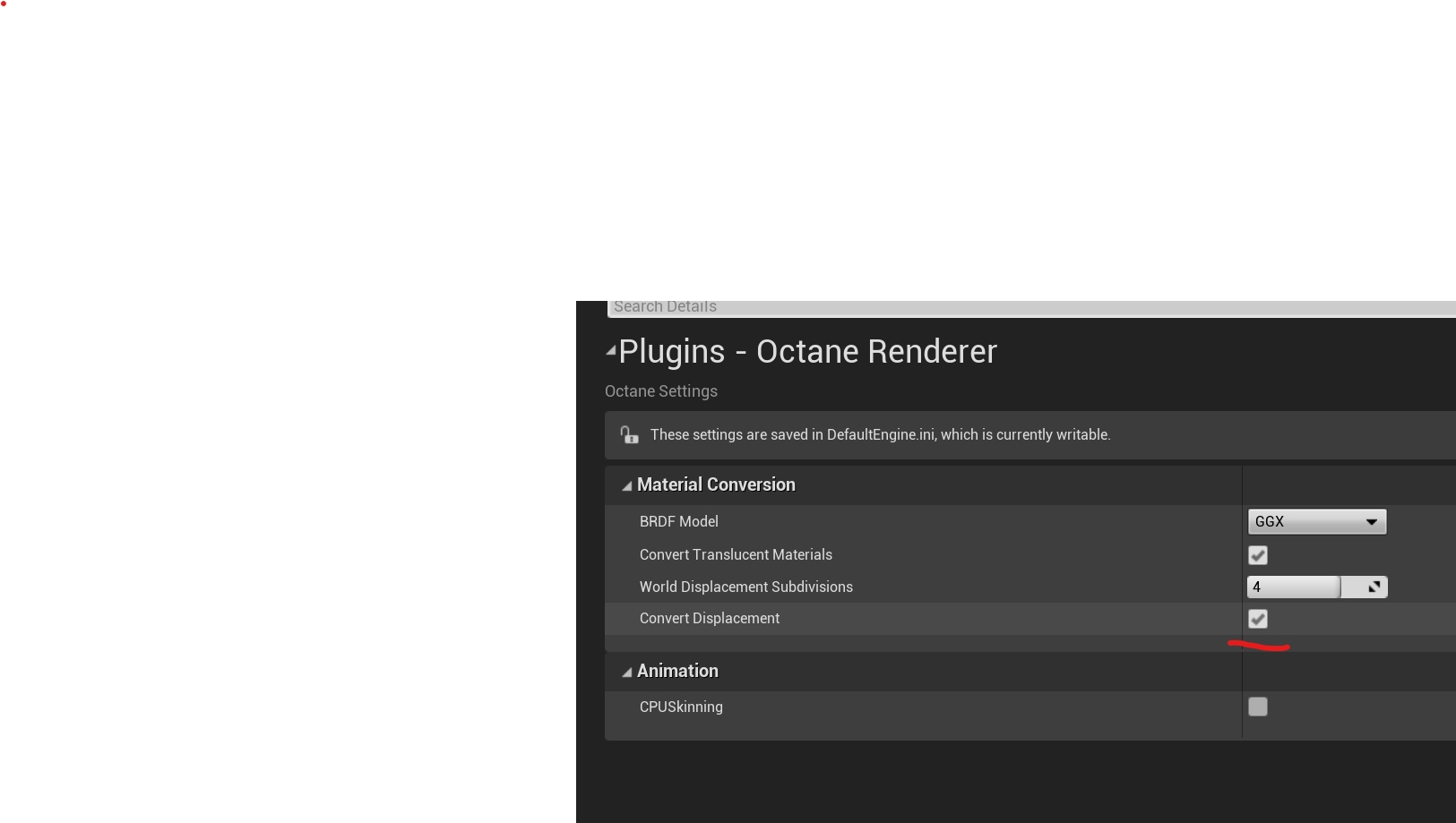

Hello! How do I use Displacement in ue4? I found this guide (https://www.youtube.com/watch?v=D-hM0hPOzz0), but I don't have the "Convert Displacement" option in the plugin setup. And connecting the displacement texture in octane instance does not give results.... :(

Displacement is partially supported, and subject to limitations. Because of this it is optional. You can turn it on in the plugin settings:
If you cant find this setting, upgrade to the latest version:
viewtopic.php?f=132&t=73883
