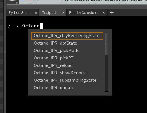

One question about ipr.
Does is have some hotkeys related to it , like hotkey for reload , alpha , etc...
juanjgon
Posts: 8867
Location: Spain
ginodauri wrote:One question about ipr.
The IPR window doesn't support hotkeys yet, but several of its functions are also available as Hscript commands that probably could be mapped on the Houdini side. If you type "Octane" in the textport, you could get the list of all available Octane Hscript commands.
Thanks,
-Juanjo
2020-02-02 12_33_13-untitled.hip - Houdini Apprentice Non-Commercial 18.0.348.jpg
