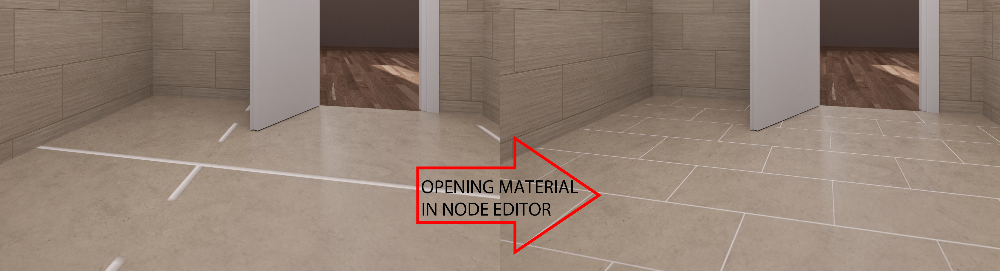

One question: all of materials created using "tiles" c4d shader look wrong, till I open material in node editor nad it is rendered correctly.
Is it a way to fix it? Then, as already asked in the past, is there a way to achieve same thing natively in Octane? I mean, having a shader able to let me decide color and grout lines color, seamless since procedural..

What's wrong you mean! Please attach some visual data. Osl texture is for re-writing for a tile texture for example, it provides real procedural results.shine71 wrote:Hi Ahmet!

Hey Ahmet!aoktar wrote:What's wrong you mean! Please attach some visual data. Osl texture is for re-writing for a tile texture for example, it provides real procedural results.shine71 wrote:Hi Ahmet!
Thanks Ahmet and everyone can help!
Merry Christmas!!!
Thanks for replying!
I'm attaching an example.
I took a look in the past to OSL texture, but it looks giving less versatility than C4D original one....

It doesn't make any sense! Could you send me a sample scene?

here it is, Ahmet!
Just a plane with a meterial.
Open scene and render.
Then, open amterial in node editor and render again..

It seems doesn't use C4D shader resolution from material parameter without doing that. I'll fix thatshine71 wrote:sorry, missing texture...
