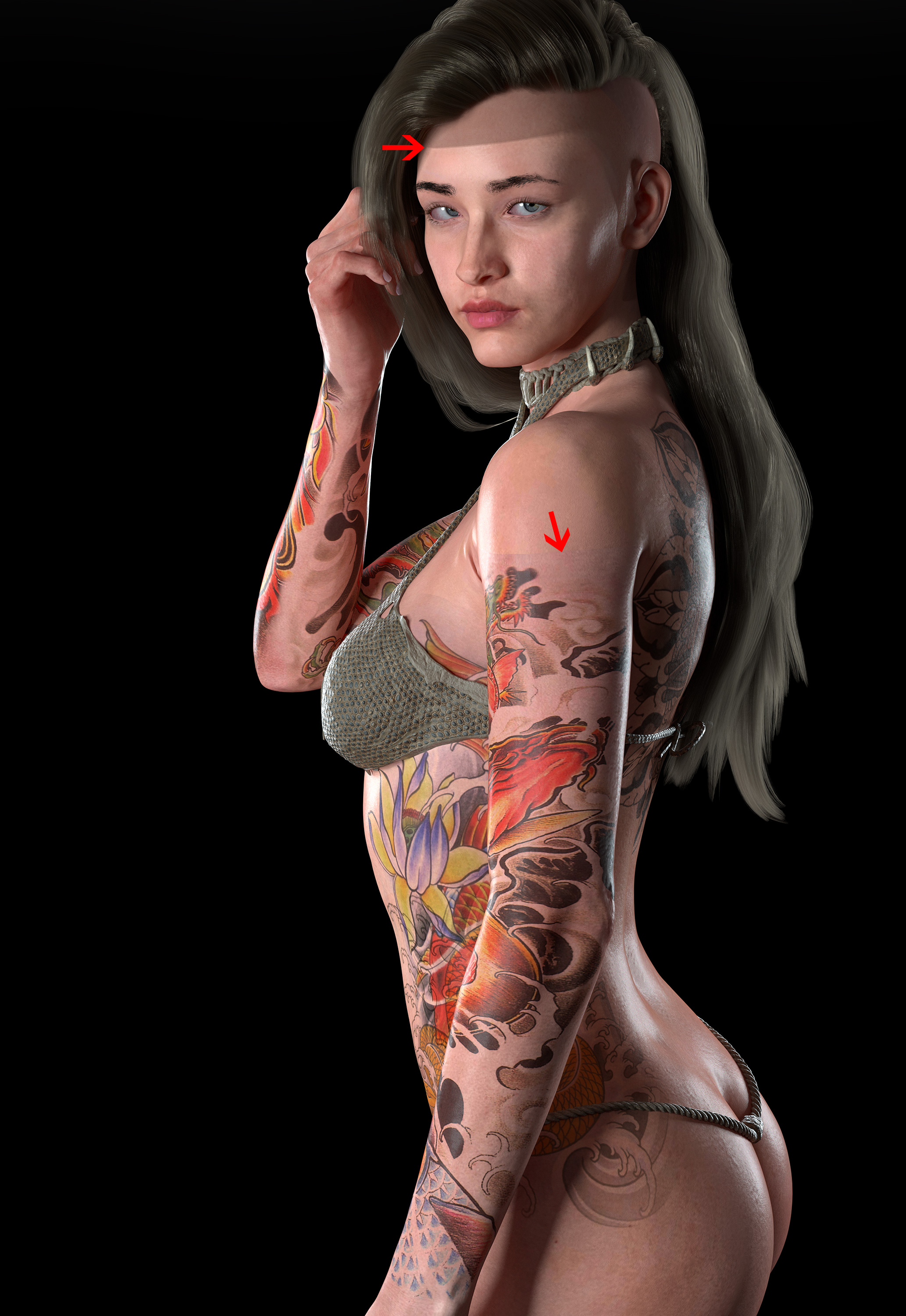

I second rajib's post - OOC is definitely broken in this release. No matter what OOC or GPU headroom size I chose, as soon as content will go OOC, the render engine crashes.
There seem to be issues with alpha-mapped-non-strand-based hair figures on top of meshes with random walk sss mediums enabled. (Check image attached)
Also, with random walk sss, you seem to be getting visible seams, when a mesh is comprised of several UV like the Genesis figures (Also visible in image attached)
Overall, I'm super happy, with how random walk sss can be used to enhance render quality and how it can be adjusted so much better, than the previous medium types.

Yup, same issue with the random walk SSS. There are visible seams in the UV (arms, legs, torso, face). If you use the SubSurface Scattering render pass view, they are really visible. I agree, it does give better results. Hopefully, Otoy fixes this in the next build.
