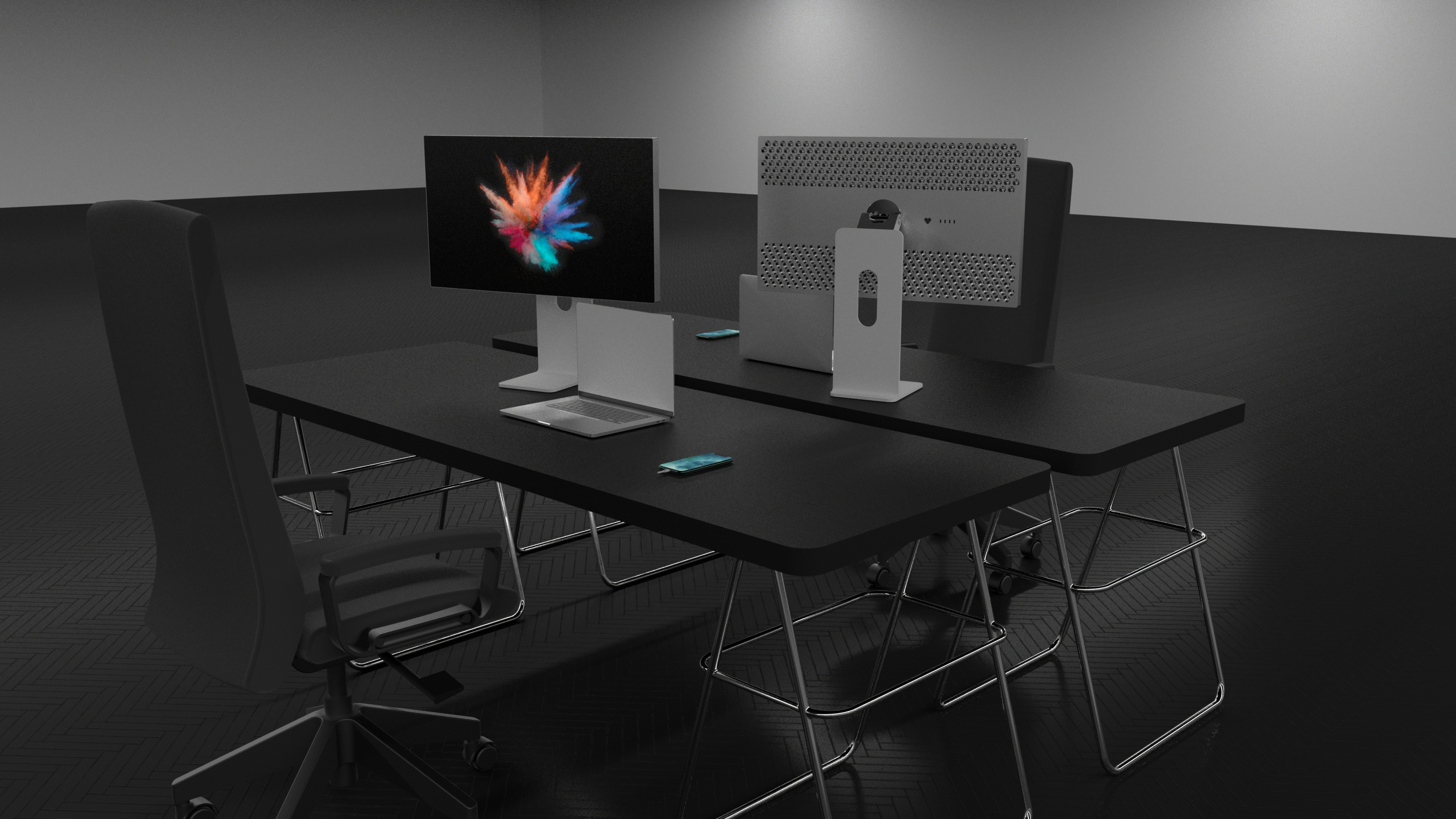

So I have this scene to replicate an Apple User office, with Macbook pro / screen etc.
Rhino is crashing everytime I use the Material Library, I guess, this is due to the Octane render plugIn, but I couldn't tell for sure.
If someone could have a look it will be a great help !
