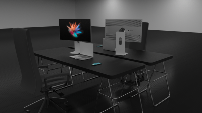

So I have this scene to replicate an Apple User office, with Macbook pro / screen etc.
Rhino is crashing everytime I use the Material Library, I guess, this is due to the Octane render plugIn, but I couldn't tell for sure.
If someone could have a look it will be a great help !
I can't figure out if the issue come from Rhino, the file, Octane, etc
I have updated Rhino / Octane and Nvidia Drivers
you can download the file here
https://1drv.ms/u/s!At5A_BiLe7H5hvlrPjk ... A?e=7vZ92A
Rhino crash down when open the material tab
