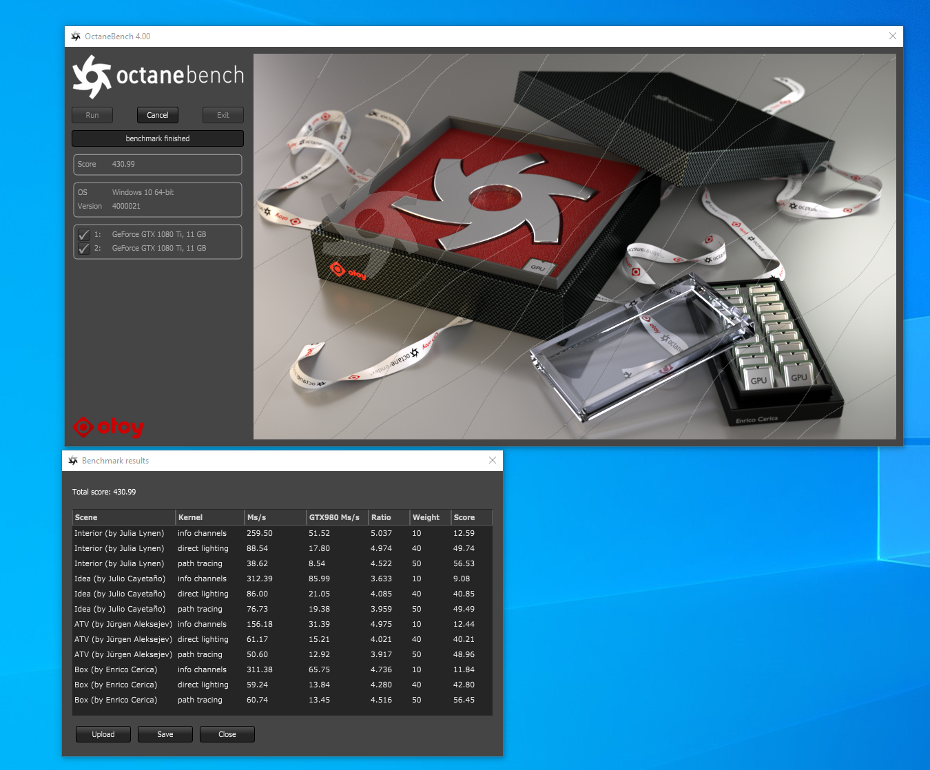

Running the octane bench is no problem.
I have two ZOTAC 1080 Ti (ZT-P10810B-10P) and installed the nvidia driver 26.21.14.4128 (Nvidia 441.28).
My OS System is Windows 10 Home.
