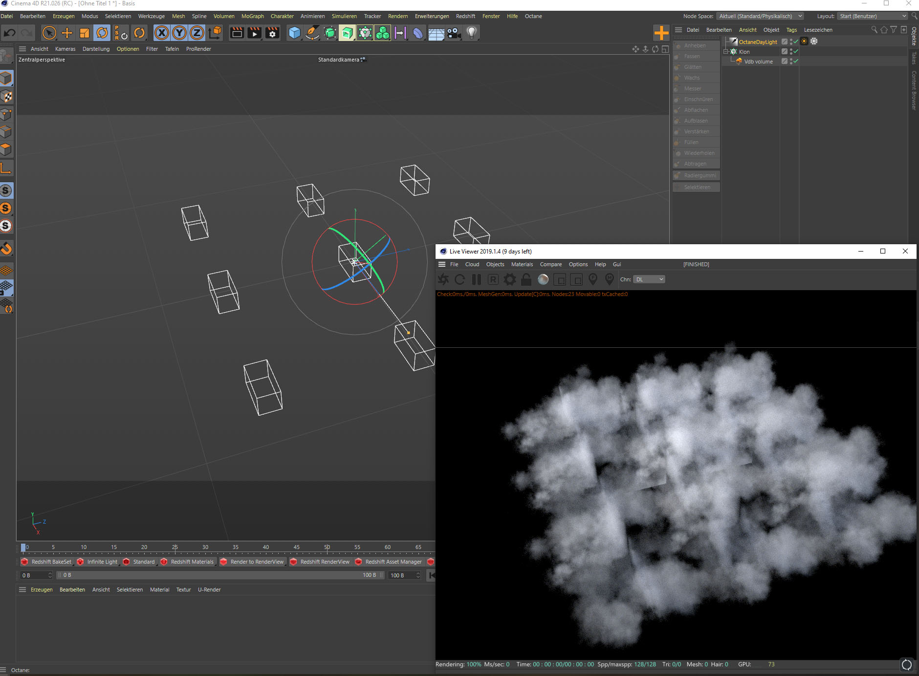

Hello, everyone,
I have a problem with the overlapping of the bounding box of VDB clouds.
I want to build a compact cloud front from single clouds in C4D using the cloner tool. Unfortunately there are big problems with the overlapping of the clouds (Boundig Box), see picture.
I tried a lot with the VDB settings - "Density", "Volume Step Length" but nothing worked.
Is there a solution or a workaround?
I'm looking forward to constructive answers - thank you!
Best regards, Udo
Posts: 10532
this technique is not good, Volumes have issues when overlapped.

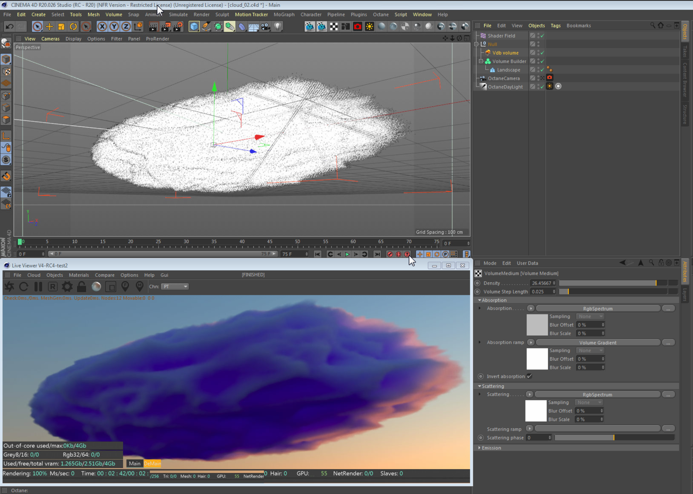

Better to create the volume composition you need in c4d R20/R21, and import back as vdb:

Hello, Beppe,
Thank you so much for your answer.
Yes, I know your technique, but I can't get the quality I get with "real" cloud VDBs.
By the way, Redschift has no problems with VDB - Bounding Box Overlay.

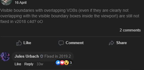

As far as I can remember, Jules confirmed on FB a few months back it shouldn't be a problem with, I think, 2019.2 anymore...

Really frustrating... I didn't need it in my last projects but was certain it would be fixed. Here the statement from Jules:
Maybe a dev could say something on this?
I know I'm not helping, just wanna point out how Otoy communicated this problem.
Edit: one suggestion: you have to use the same step length on every VDB object. Lino even showed that it was fixed:
https://www.facebook.com/groups/OctaneR ... 185411390/
