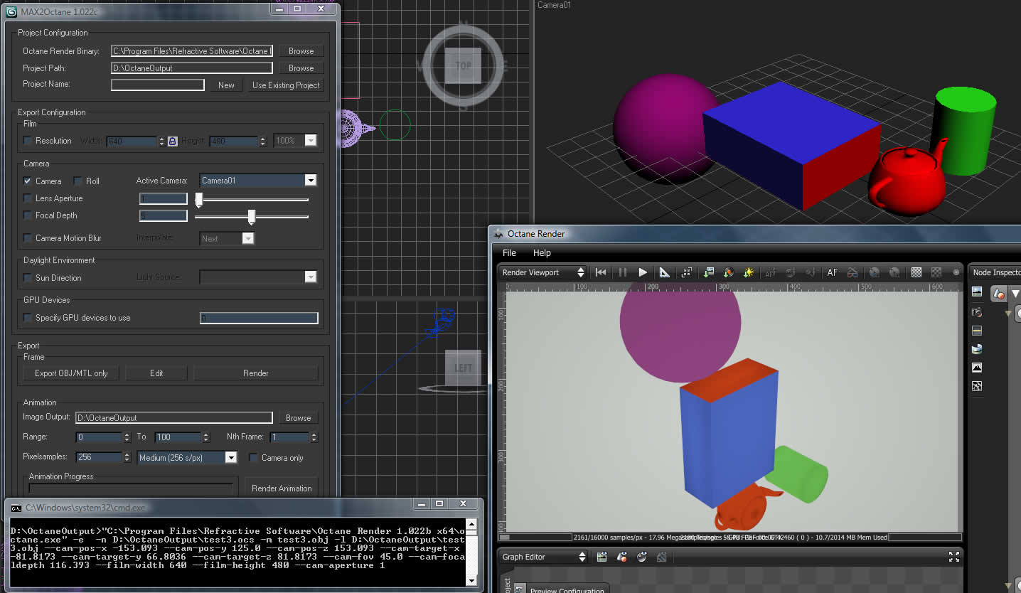

Thank you for the suggestions and sorry about the delayed response. Last week was a bit crazy.
I ran a few tests. I created a simple scene and exported it to Octane. The scene came in on its side. The attached screen shot shows the original in Max 2010 and the results in Octane. I set my units to meters (was cm before), but it didn't change the result.
With the listener on, all I get is "NEWproject = true".
If I delete the camera and export, Octane creates one as you explained, but the result in Octane is the same.
I should mention that if I uncheck Camera in the Export dialog, I get the following errors, but I suppose that this is to be expected.

Attached is an example Max file and the OBJ and Octane files that the plugin creates. When I export to Octane, the models are off screen and tilted 90 degrees. I can drag the model into the screen from the left, but the camera adjustment controls are so sensitive that I can't get the scene reoriented and in the frame. A slight adjustment causes the model to fly off in one direction or another.

I tried your file, one reason for the strange camera behaviour could be that your camtarget is way behind the teapot.
When moving in octane it will orbit around that target.
Obviously there is an error, but i dont see why this should happen:
