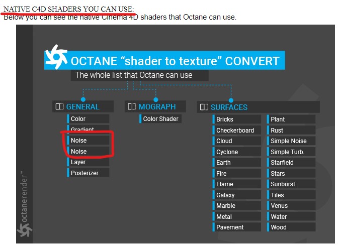

It's noise crash, I don't advice to use c4d shaders by crashes.

They are not yet supported by helping of osl scripts. Planned for futureHTK421 wrote:But I thought procedural C4D noises were now supported, and we no longer had to bake procedurals into textures...
Is that not the case ?
