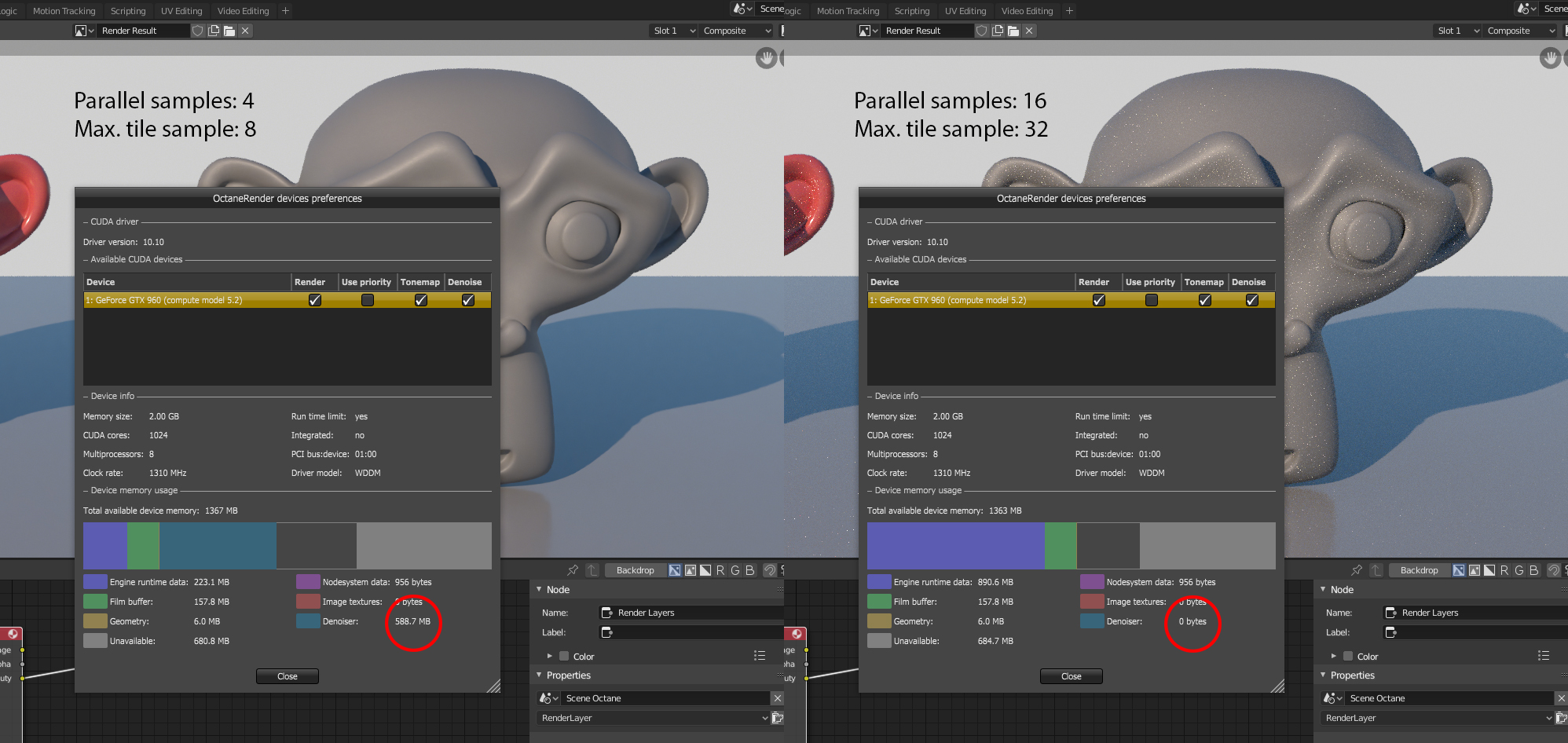

I have been playing around with some of the kernel settings.
If I set Parallel samples to 16 and Max. tile samples to 32 the denoiser no longer works in your scene.
Strangely, if I lower it back to 4 and 8 it still doesn't work.
I have to close and then re-open blender.
I think it's the graphics card running out of memory and might explain why it happens on my machine but not yours.

richardwright wrote:I have been playing around with some of the kernel settings.
Be aware that Parallel samples can take quite amount of GPU memory. Default high setting at 32 is in my opinion too high compared to the speed increase it offers. 4 or 8 is optimal in most cases. If you have 11GB memory it might be useful to have it higher but not 32 as it does not offer any speed increase compared to setting at 16 or 8.
If you can connect your display to other GPU that is not used for rendering. This may get gack some memory that is used for display and other apps.
