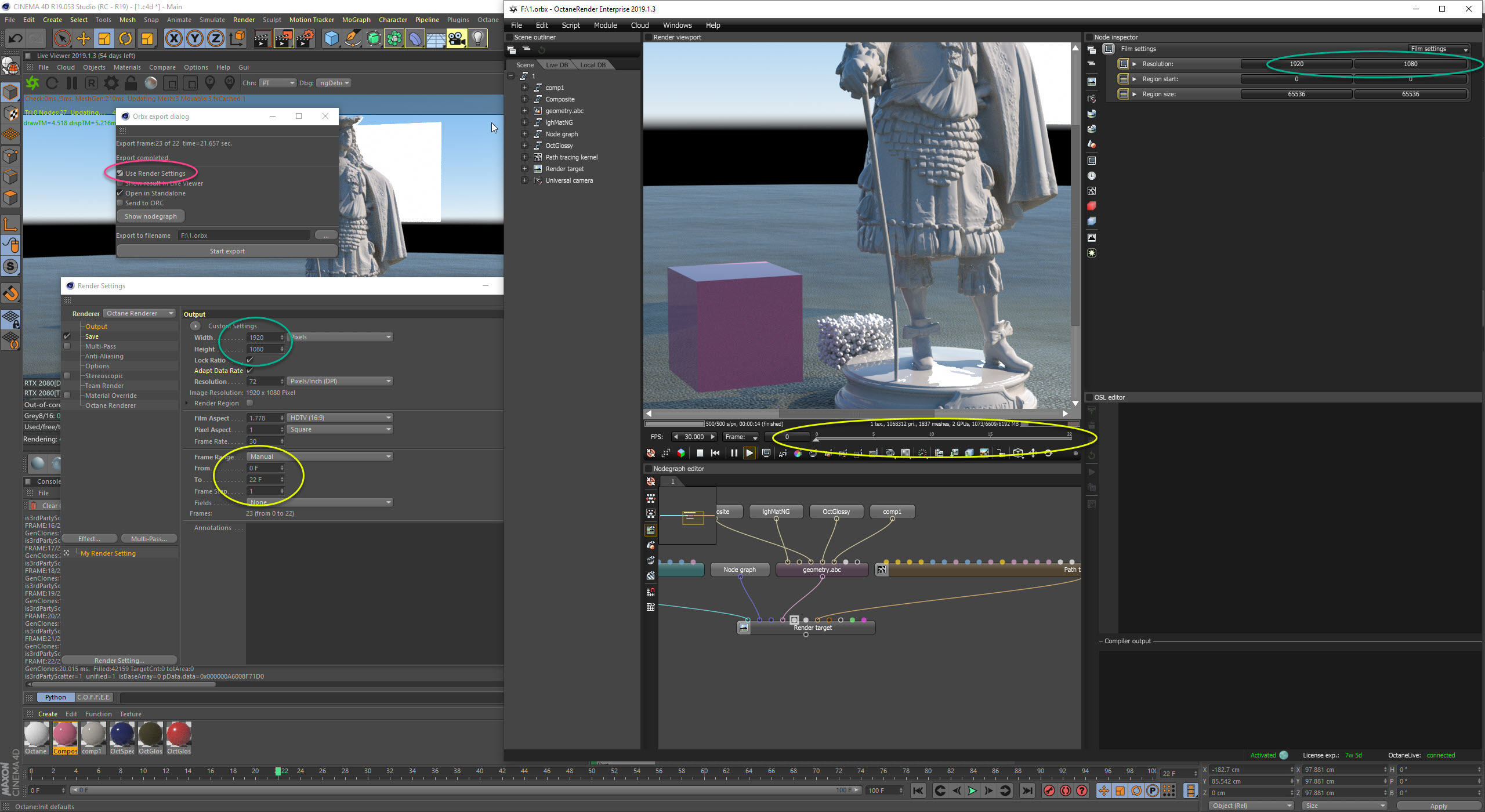

I think It's working as expected. See image

aoktar wrote:I think It's working as expected. See image
Should have mentioned I'm using 4.05-R7 I guess.
I don't even get an export dialog like in your screenshot.
http://www.jopfe.com - freelancing motion designer and 3d artist
Posts: 10564
You need to Save as Animated package .orbx (alembic) to see the export settings dialog.

Posts: 16068
Location: Türkiye
This part is unchanged since long time, same for most of old builds.
