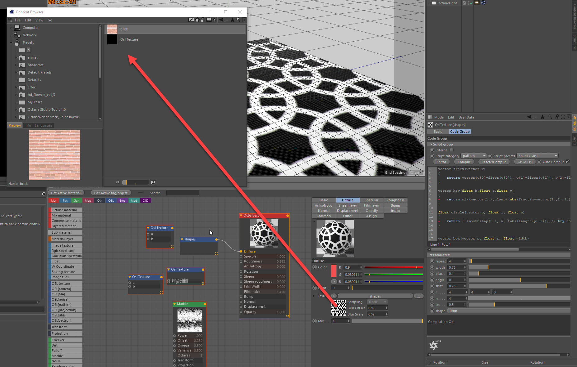

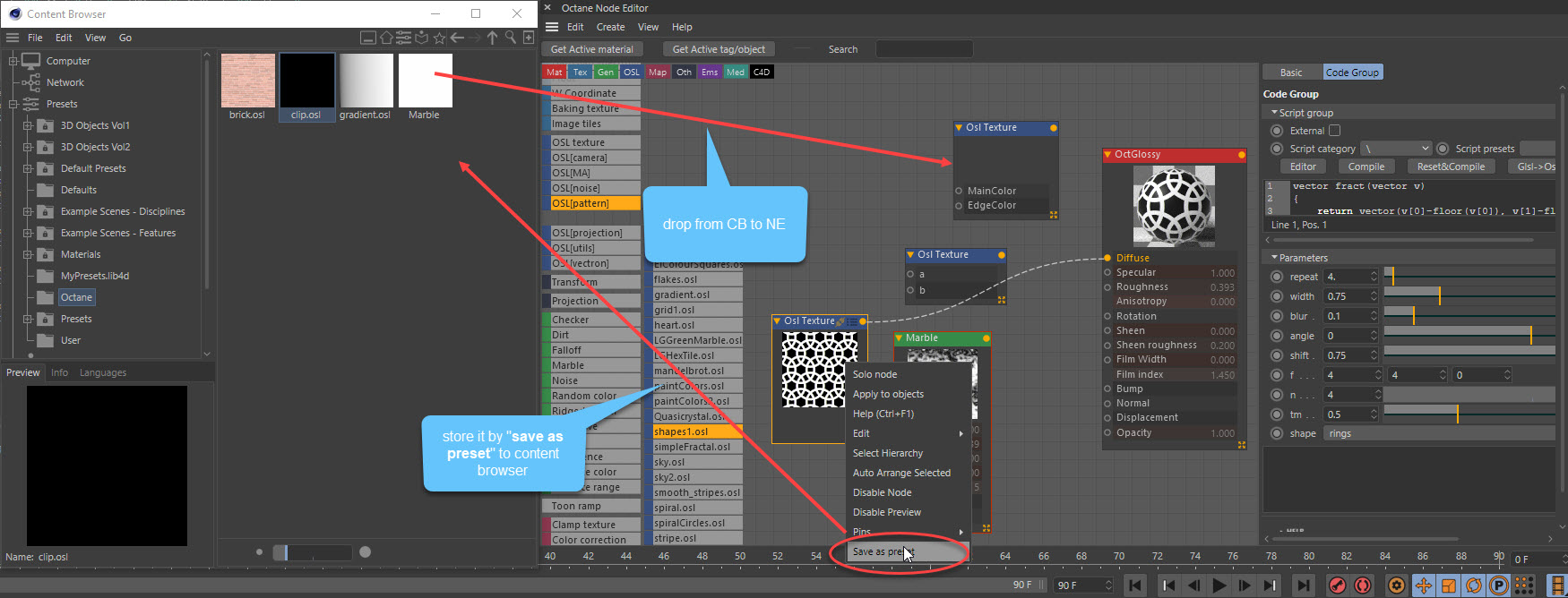

Aoktar, this looks amazing already! Can't believe you've got a working prototype already. From the looks of it it covers pretty much everything that I wanted from the implementation... I think I will be using OSL a ton more because this makes it super accessible and I hope other users will too.
Thanks I've made the revision in last two days, still working on. Hoping to put it for next release.nejck wrote:Aoktar, this looks amazing already! Can't believe you've got a working prototype already. From the looks of it it covers pretty much everything that I wanted from the implementation... I think I will be using OSL a ton more because this makes it super accessible and I hope other users will too.
Additionally I'll add simulate version for some c4d shaders as an option.
I'm really excited about it, thank you again for getting the ball rolling here!aoktar wrote:Thanks I've made the revision in last two days, still working on. Hoping to put it for next release.nejck wrote:Aoktar, this looks amazing already! Can't believe you've got a working prototype already. From the looks of it it covers pretty much everything that I wanted from the implementation... I think I will be using OSL a ton more because this makes it super accessible and I hope other users will too.
As for saving to the content browser, yes, we can do that and it is useful for sure. Truth be told I didn't know about it until you've pointed it out (thanks for that
Right now I'm docking another content browser window on the other screen with the OSL maps that I use in pretty much every material. It works fine but on a bigger screen there is potentially a lot of mouse movement going on plus one needs to leave the nodal editor in order to use his own saved OSL nodes.
Just seems like a really great and handy addition if we'd have these in the nodal editor
