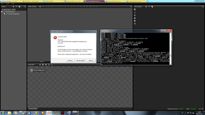

First off all THANK YOU!! for this superb plugin! No more 2.49!! Im just so happy :)
The secound thing is im getting this error when im exporting using a already existing .ocs file.
The error occurs independent of what I save in octane, so any change in the default export settings and saving them to a .ocs file causes the error.

bepea wrote:Hi!
Not sure this has to do with the script :?
Could you check if the ocs file has been created with the same Octane version?

enricocerica wrote: Not sure this has to do with the script :?
Yes it probably isn't the scripts fault, I just thought you'd might know what the problem is :)
And yes .ocs files were created on the same octane version.
Ive searched this forum for the anwser but got none. The was a guy who posted a similar error but got ignored in the main 23v5 version thread.
Despite this error in all other aspects the script works perfectly, its so smooth to use and makes working with blender and octane so much easier!
