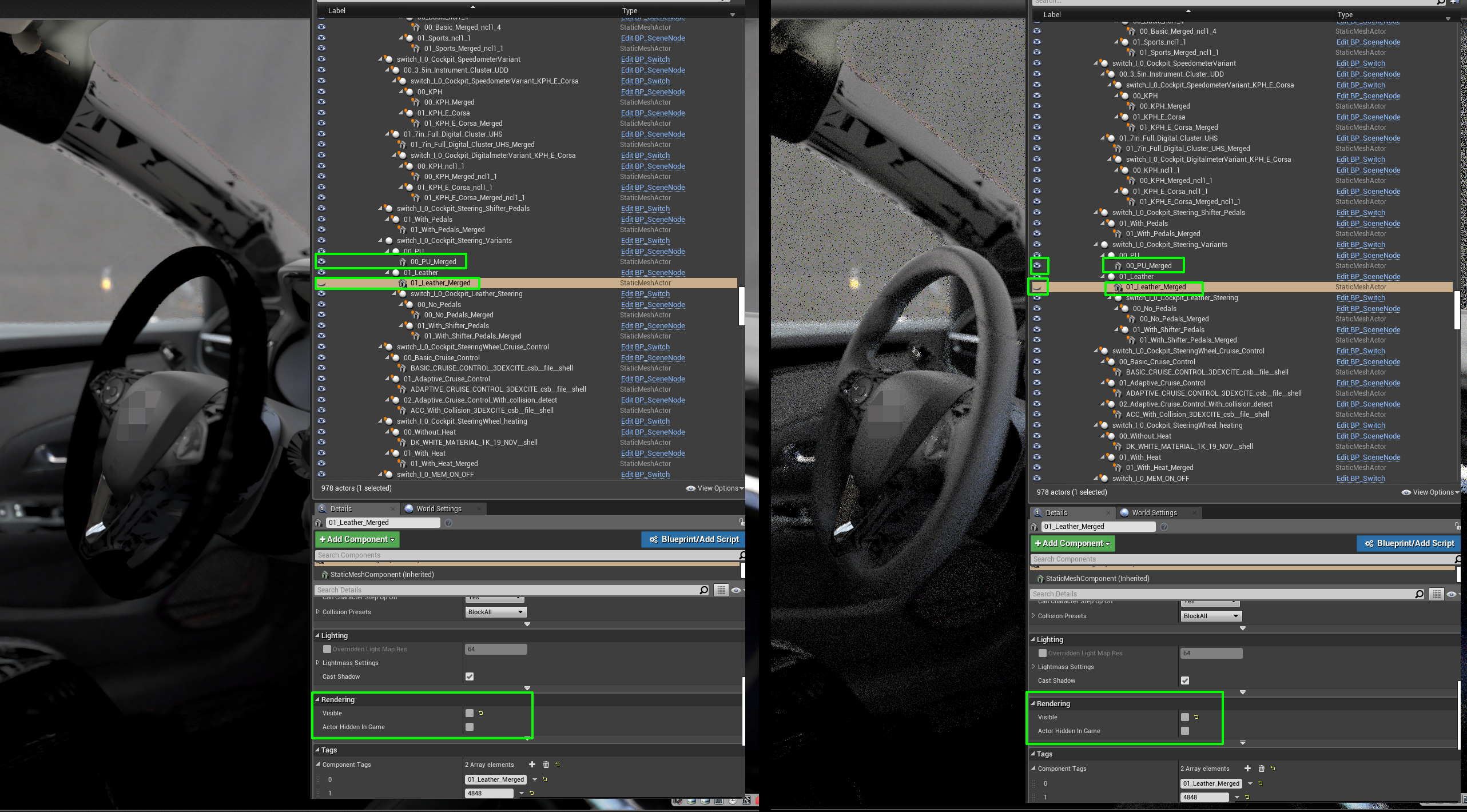

i get a weird double geometry phenomena in octane. So i have two variants lets say the steering wheel. The geometry looks almost the same and the objects sitting on the exact same postion. My Variant Manger sets one of these to "visible off" under the rendering section on the static mesh settings. It disappears in the viewport and in the octane renderview but now it causes ugly double geo effects...like its casting shadows and so on... any ideas? Once i switch off the "eye" in the world outliner its fine...but thats not the solution.

The component visibility is linked to the ObjectLayer camera visibility, which means the geometry is invisible to the camera, but still casts shadows.
This is not the same behaviour as unreal, so i have changed it to match unreal.
The change should be in the next build.

thanks for the quick reply.
waiting for a new release than

The new release just got pushed.
