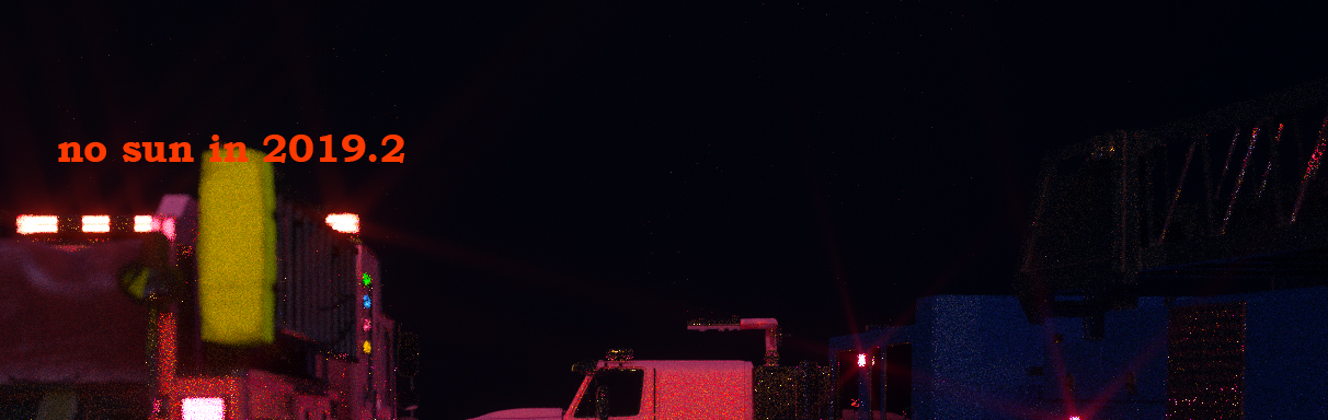

coilbook
Posts: 3171
3 problems

2. There is no sun not sure why. 2019.1 works fine
