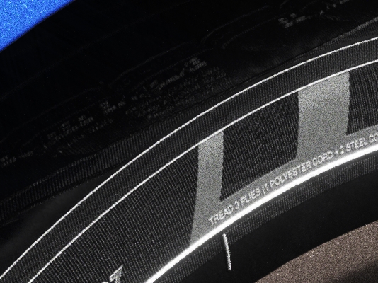

Hi friends,.. there's a strange behaviour in this version.. the displacement is ignoring the border mode of the image node... on the image atached you can see better.. the diffuse is black border and the displacement still looks wrap around..* both are in the same imagetexture node with black color Border mode

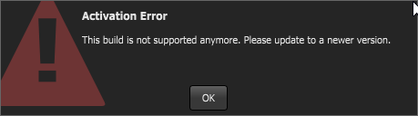

I have RC3_r2 installed but I'm getting this error message on launch and octane is deactivated. Is there not a newer 2019.1 build right now?
Raoul
Posts: 78
Joined: Sun May 25, 2014 8:24 am
I also have RC3_r2 installed and am getting this error message on launch... Can we get this fixed ASAP!!?
there doesn't seem to be a newer version to migrate to. Please don't lock us out of octane without any warning like this!
Posts: 16068
Location: Türkiye
Raoul wrote:I also have RC3_r2 installed and am getting this error message on launch... Can we get this fixed ASAP!!?
I didn't want to make a new build since we have a few critical bugs. I can make a new build to avoid your situation.
