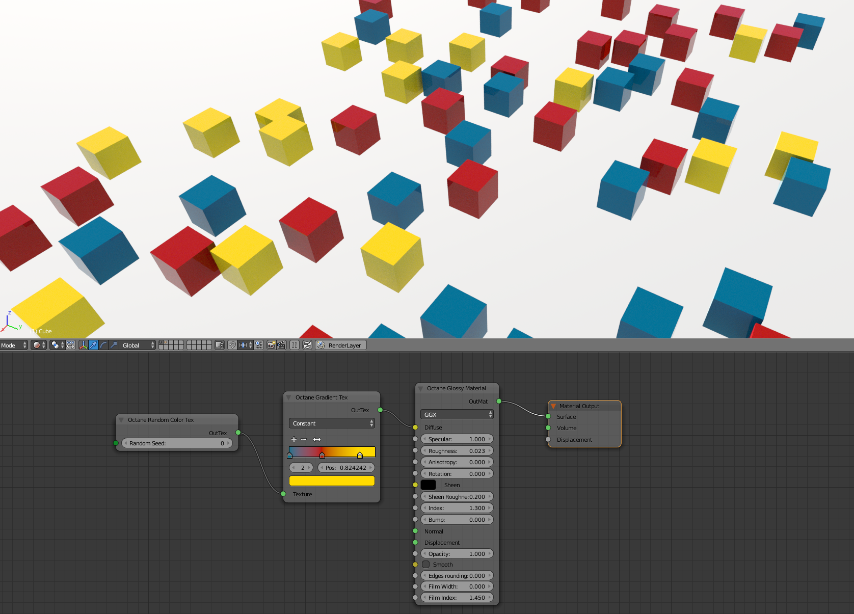

I am new to blender (coming here from Sketchup and Modo). Could you please help me of how to get random color over instances? There are many great scripts we created on the forum for random textures (with LUA too)...

you can use Random color tex as an input for gradient texture to achieve this.

Thanks for that. Question is how did you create these boxes in blender? Array modifier does not work for it.

The boxes are created using particle system in hair mode.
