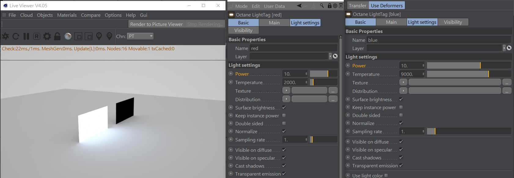

here's a scene. With both lights at power 10 the red light is not normalised and is black. You have to increase power to full for it to match the blue light.

Look at the pic. Normalise button is ON for both lights. The red light is not being normalised, but it should be.

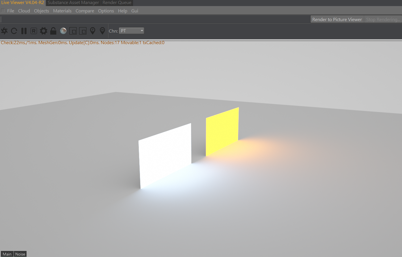

Look, here is the same scene in 4.04

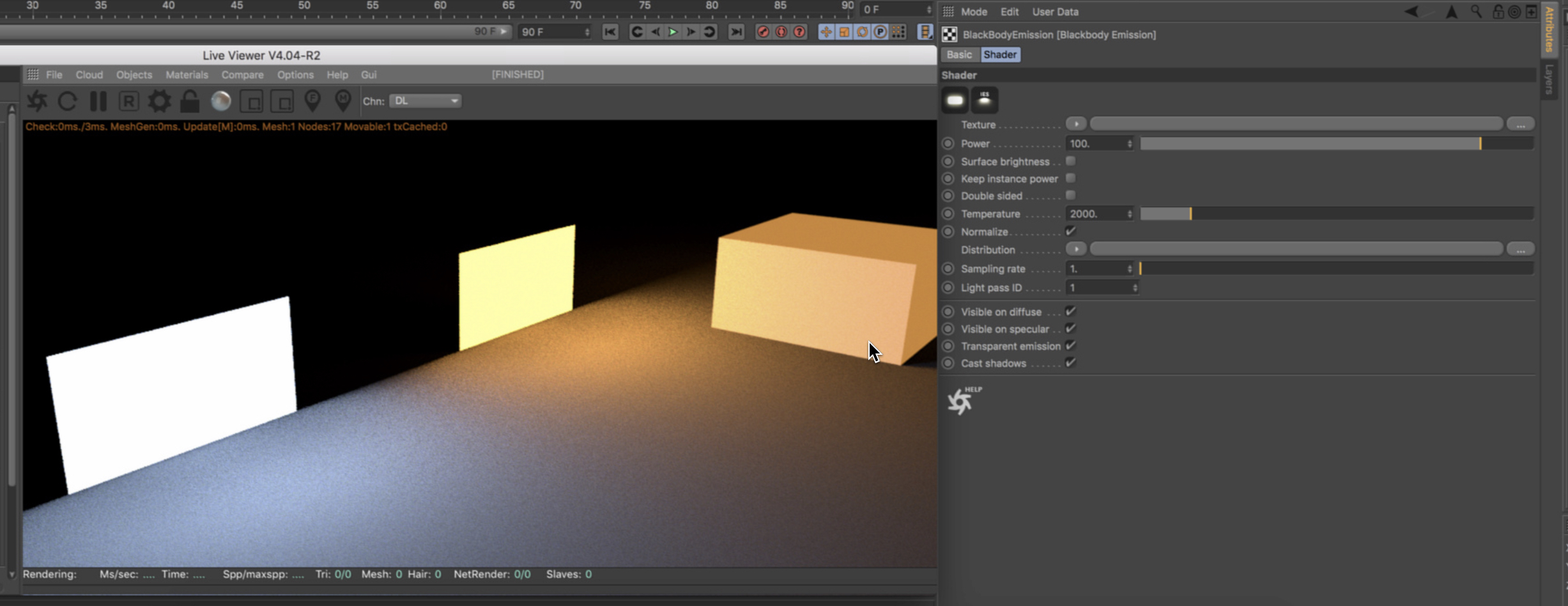

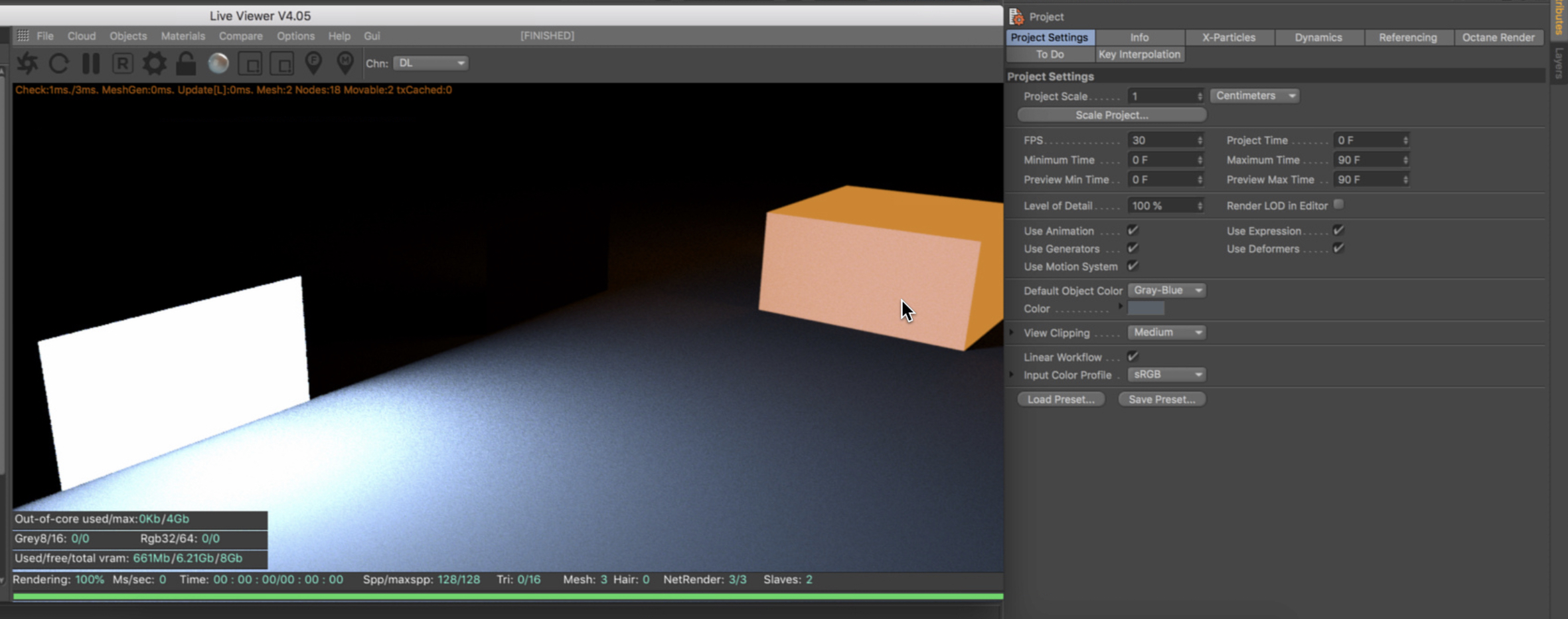

Posts: 10544
Ok sorry, now it is more clear.
The issue is related to Octane Light tags only, the Blackbody Emission is not affected, this is way I was not seeing it in the first place:
v4.04-R2
v4.04-R2
v4.05
v4.05
ciao Beppe
