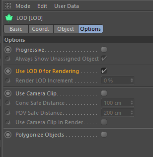

Has anyone had success using the LOD Object with Octane?
I saw that support was added in 2018.1.2-R2, but the "Use LOD 0 for Rendering" checkbox in the Options tab does not seem to work.
I have uploaded an example scene where the "Use LOD 0 for Rendering" checkbox works with the Cinema 4D renderer, but not Octane.

Posts: 16068
Location: Türkiye
I think you haven't tested it enough. It's working but note that LV is using viewport geometry data. You can see expected result in Picture Viewer.

Thanks for the reply.
I see it working in the Picture Viewer now. I was expecting it to work in the Live Viewer (similar to how it works with C4D's Interactive Render Region).
Posts: 16068
Location: Türkiye
blastframe wrote:Thanks for the reply.
As I said that LV is gathering the viewport data for geometries. So why you don't see that

aoktar wrote: As I said that LV is gathering the viewport data for geometries. So why you don't see that
Yes, I understood. No problems. Thank you for the reply.
