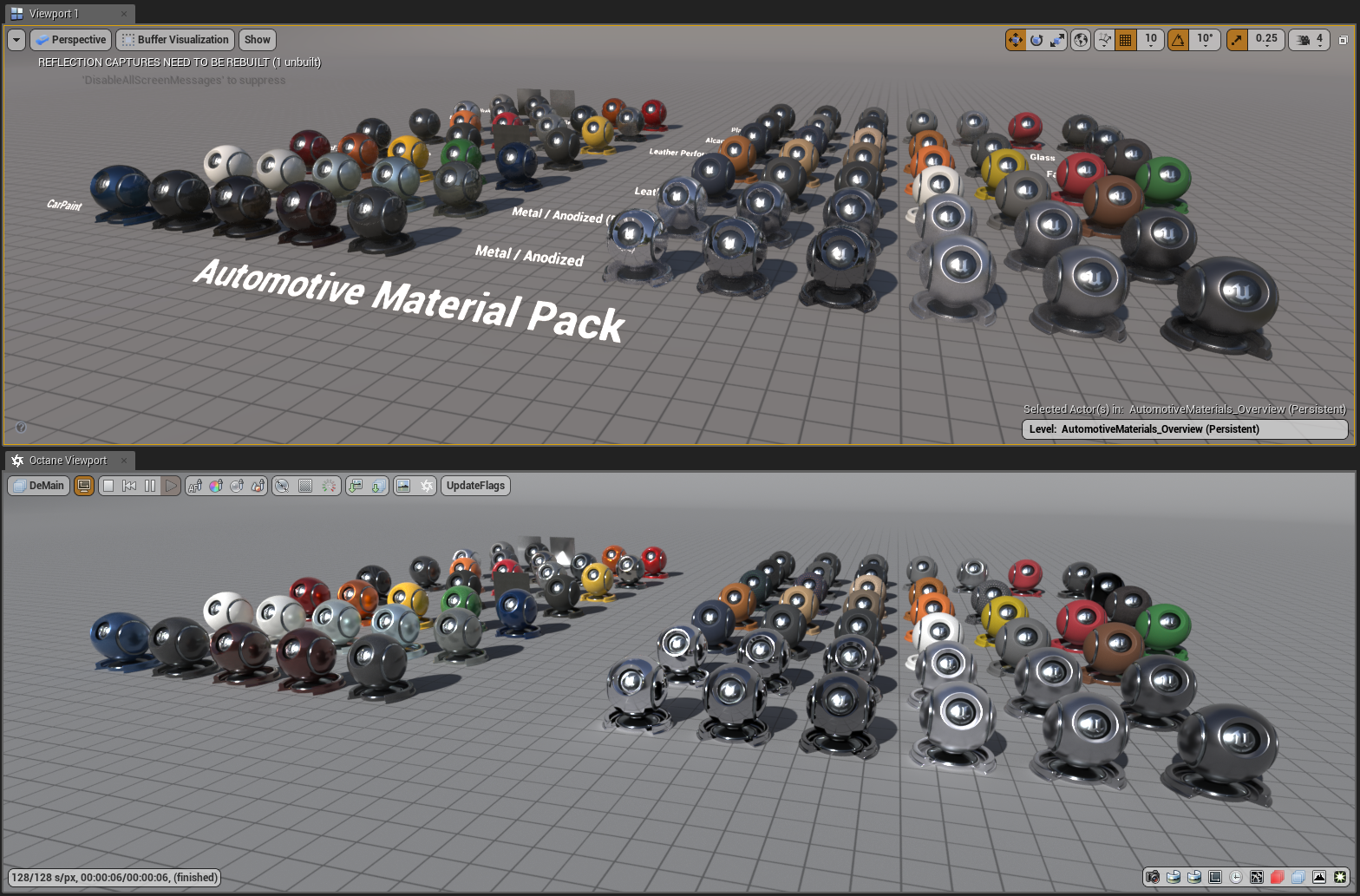

Unreal Material Conversion
Octane for Unreal automatically converts Unreal materials in the scene to Octane.
Materials are converted to OSL by extending the Unreal Material Translator, producing a high level of quality and fidelity.
At the bottom of this post is a link to a reference sheet, detailing which features are supported.
Note that in scenes with many and / or very complex Unreal Materials, changes to materials can take a long time to update.

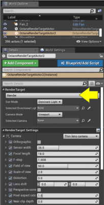

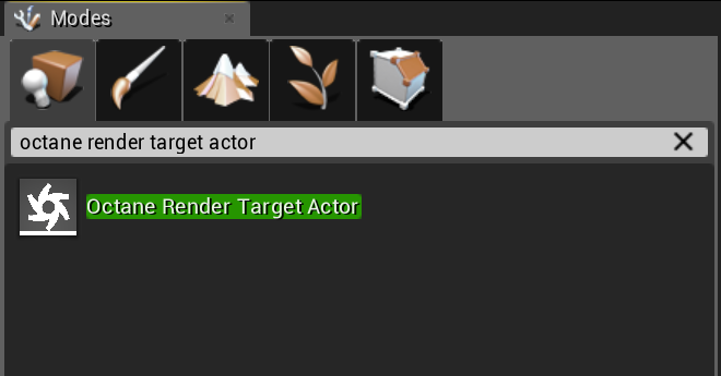

Octane RenderTarget Actor
Octane for Unreal Engine has in-editor support for Octane Render Targets.
A Render Target is automatically created once Octane is initially loaded in a scene, and multiple Render Targets are supported.
Render Targets allows users to tweak Octane’s rendering, camera, post processing and many other settings.
They are created via the Modes-window, just like any other actor.
Once created, the rendering process is initiated with the “Render” button at the top of the Render Target’s details.

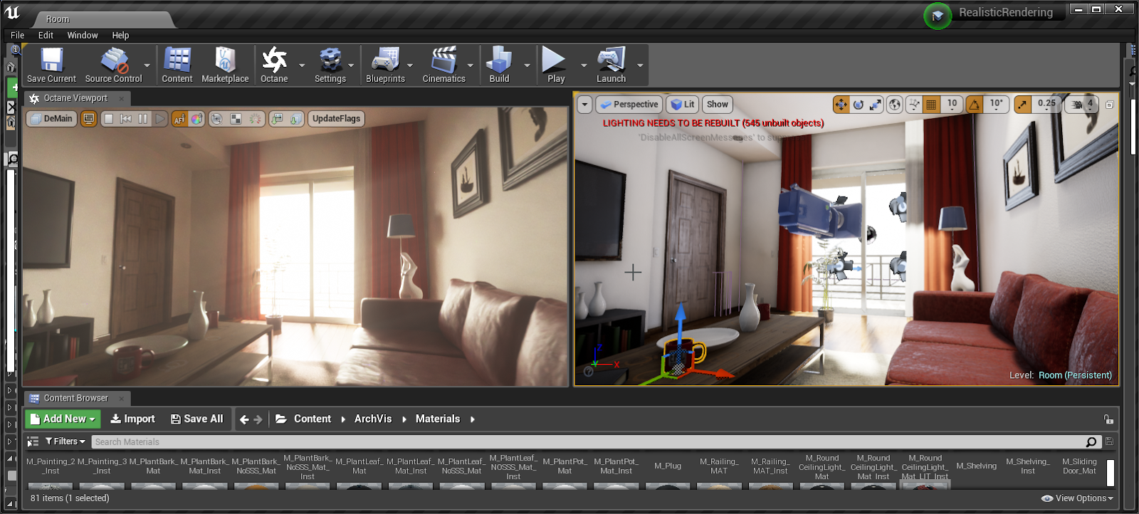

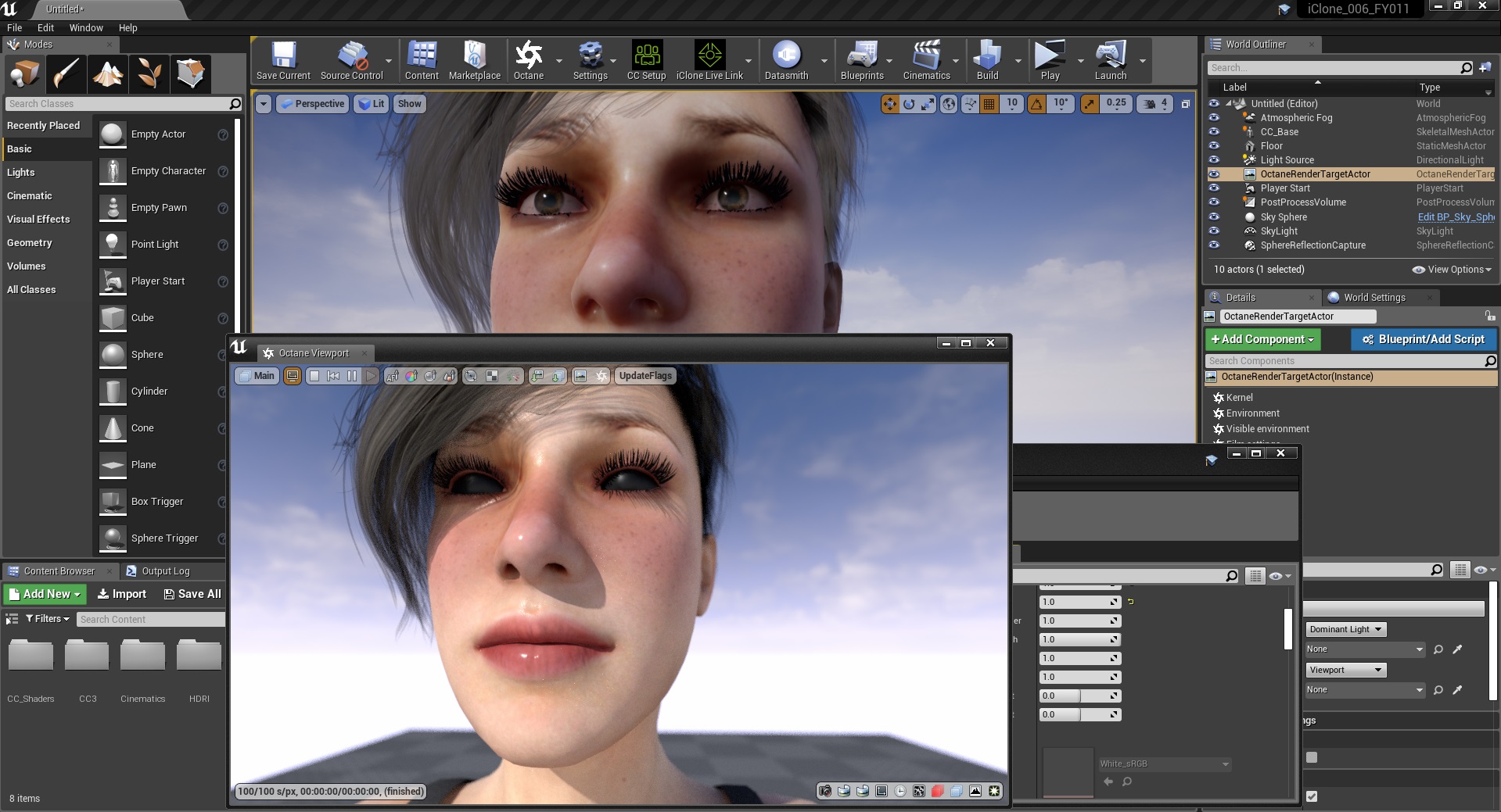

Octane Viewport
Octane comes with its own viewport window. This can be docked like any other window in Unreal.
An overview of these features:
Top section:
  • Render pass selection
  • Auto-resize render to viewport toggle, note that this overrides settings in the active render target’s “Film settings” panel
  • Stop, restart, pause, start rendering buttons
  • Auto focus picker, note that this overrides settings in the active render target’s “Camera” panel
  • White balance picker, note that this overrides settings in the active render target’s “Imager” panel
  • Material picker, this reveals the target material in the Content Browser
  • Object picker, this reveals the target object in the World Outliner
  • Render mode override (normal / clay / colored clay)
  • Sub-sampling settings, to increase viewport performance
  • Render priority setting
  • Save the current render pass to disk
  • Save all render passes to disk
  • Set the currently active render target
  • Open the Octane node graph (unsafe)
  • Set update flags, these control Octane’s link with Unreal
Bottom section
  • Render statistics overview
  • Buttons to quickly navigate to various elements of the active render target in the Details view

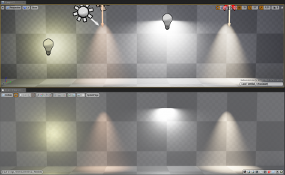

Unreal Lighting
The plugin supports the following Unreal light types:
  • Rect
  • Point
  • Spot
  • IES
  • Directional*
Additionally, the plugin supports emissive materials and components.
*At the moment only one directional light at a time is supported: this acts as the scene’s sun direction.

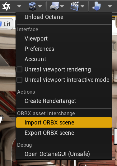

ORBX Import and Export
Octane for Unreal can export any Unreal Scene to ORBX files for use in Octane standalone and other Octane DCC tools.
Octane for Unreal can also import ORBX files and use ORBX assets and proxies as Unreal scene components.
This feature allows users to mix their Unreal assets with ORBX assets from other Octane Plugins.
Simply drag an .orbx file onto the Unreal Editor content browser to start using ORBX assets.

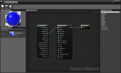

Octane Materials
Octane for Unreal provides a way to override an Unreal material on the Octane side, without affecting the original scene.
This can be done in an Octane Material, available in Content Browser → Octane. This material has an option to specify a parent
in the Details tab, which exposes its parameters for use in the Octane node graph via the Parent Material node.
That way, changes made to the original material are reflected in the Octane material.

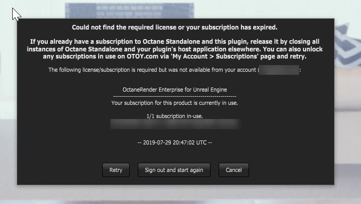

Very excited to try this out however I'm getting this message every time I try to run Octane in Unreal. I'm on the Enterprise subscription and signing in and out does no good, neither does quitting Modo and Octane standalone.
ChrisHekman
Posts: 1162
Joined: Wed Jan 18, 2017 3:09 pm
villagefeatures wrote:Very excited to try this out however I'm getting this message every time I try to run Octane in Unreal. I'm on the Enterprise subscription and signing in and out does no good, neither does quitting Modo and Octane standalone.
The error says your account is linked to another PC. You can unlock your enterprise license by going to
https://account.otoy.com/sign_in
Go to licenses (or subscriptions) and see if you can unlock your enterprise licence.
villagefeatures
Posts: 22
Joined: Wed Apr 29, 2015 3:14 am
Thanks! that did the trick.

Sorry for my super-ingenuous question: could be possible, having a scene made in Octane StandAlone, to export in Unreal+Octane without loosing all the materials?
Thanks to all.
Luca
i9-10900x, 96GB DDR4, 2xRTX 2080 TI, ASUS X299 SAGE, Windows 10
http://www.visual4d.it
ChrisHekman
Posts: 1162
GIOLETS wrote:Sorry for my super-ingenuous question: could be possible, having a scene made in Octane StandAlone, to export in Unreal+Octane without loosing all the materials?
Thanks to all.
Luca
Yes, we support imporing and exporting orbx files.
You can export your scene from octane standalone as an ORBX.
Then import that ORBX file in unreal by either dragging the file in from explorer, or by using the import orbx option shown above.
This action will create an orbx asset that you can drag into your scene.
The ORBX scene will then be shown in the octane viewport as an ORBX Proxy.
In upcomming builds there will also be a way to convert an ORBX file to a set of unreal assets (textures, meshes, materials, levels, etc)
