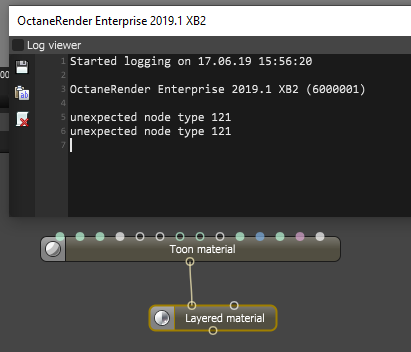

Connecting a Toon Material to a Layered Material's "Base Material" pin gives this error:
Code: Select all
Started logging on 17.06.19 15:56:20
OctaneRender Enterprise 2019.1 XB2 (6000001)
unexpected node type 121
It also seems to hang Octane for a while if you try to stop the viewport. Restarting gives this error:
Code: Select all
device 0: failed to bind device to thread, since it's already bound
device 0: failed to initialize context
After closing standalone, the process doesnt die and cant be killed in task manager either. GPU-Z shows 100% GPU load

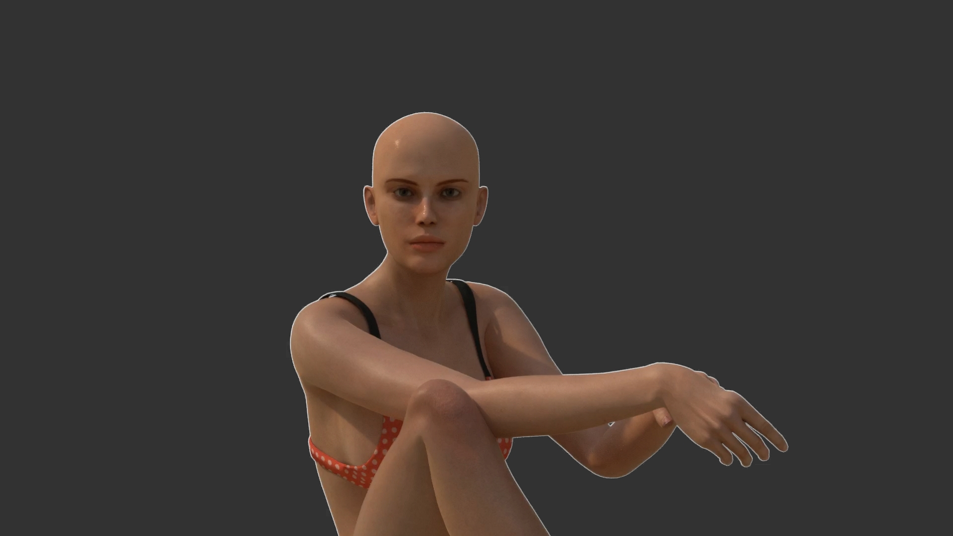

Not exactly the same, but I have found in general that all of the render pass masks do not match the item being masked. If you actually use them for compositing there is always an outline.
Now, if you use a straight PNG with alpha over a background, it works great...BUT, this is good for single images.
But for an animation, where you would want to compose a mask video layer and perhaps have >2 layers with masked items in front back of a main layer, the render pass masks are useless because they don't match what is rendered in Main pass. Octane does not have good render pass masking for some reason. (This would be Render Layer Mask, Object Color, Object ID, Render Layer ID, etc)
