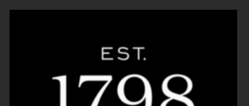

I have used a displacement map to emboss some lettering on a bottle. There are two materials on the bottle, one undisplayed and one with the displacement which is restricted to an area defined by a polygon selection tag
There is a visible join where the two materials meet causing subtle problems with refractions and reflections.
Any ideas on how to fix this?

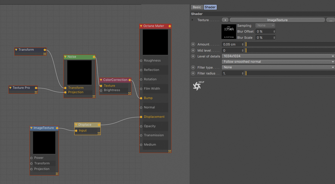

please post a screenshot of that portion of the map, and also a screenshot of the displacement node, thanks.
The Mid-level value has to follow the background color/intensity, or you can have a little displacement in that zone.

Mid level is at 0, displacement map is at RGB 0;0;0

the problem is where the underlying material with no displacement meets the material with displacement which is restricted to a selection set. The two materials are stacked.

You should make the map fit the entire shape. That will remove the boundary issue.

Yes, have the map fit the entire bottle. Doing so guarantees that the elevations of the displacement will be consistent.
