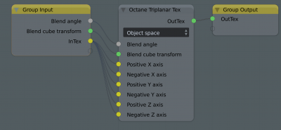

Can we have one common input instead of many if I want to plug in one texture to all inputs?

Don't know if this will be added (since it doesn't exist in SA, but it would be nice if they did..).
I would solve this by creating a node group, like this (Also in the appended .blend): Just add to you startup file and it should be ready to use in every new project (and/or import to existing projects).

Yes, this could work. Was thinking about doing the same
