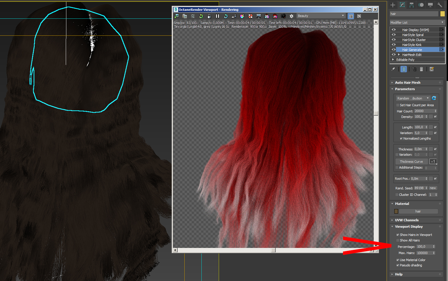

Thank you for the reply paride.
But the settings you are pointing to is a part of the issue.
As my example above.
If i have 2 000 000 in the "Hair count" slot.
100% in "Precentage"
and 50 000 in "Max Hairs"
It will still only render 50 000 because that's what is displayed in the viewport.
While i expect it to render 2 000 000 hairs because that's the hair count i have set to generate.
And from what i can see i can only crank up "max hair" to "999 999"
In other words, that seems to limit octane to only be able to render 999 999 strands of hair or lower.
Atleast this is how it behaves at my end.

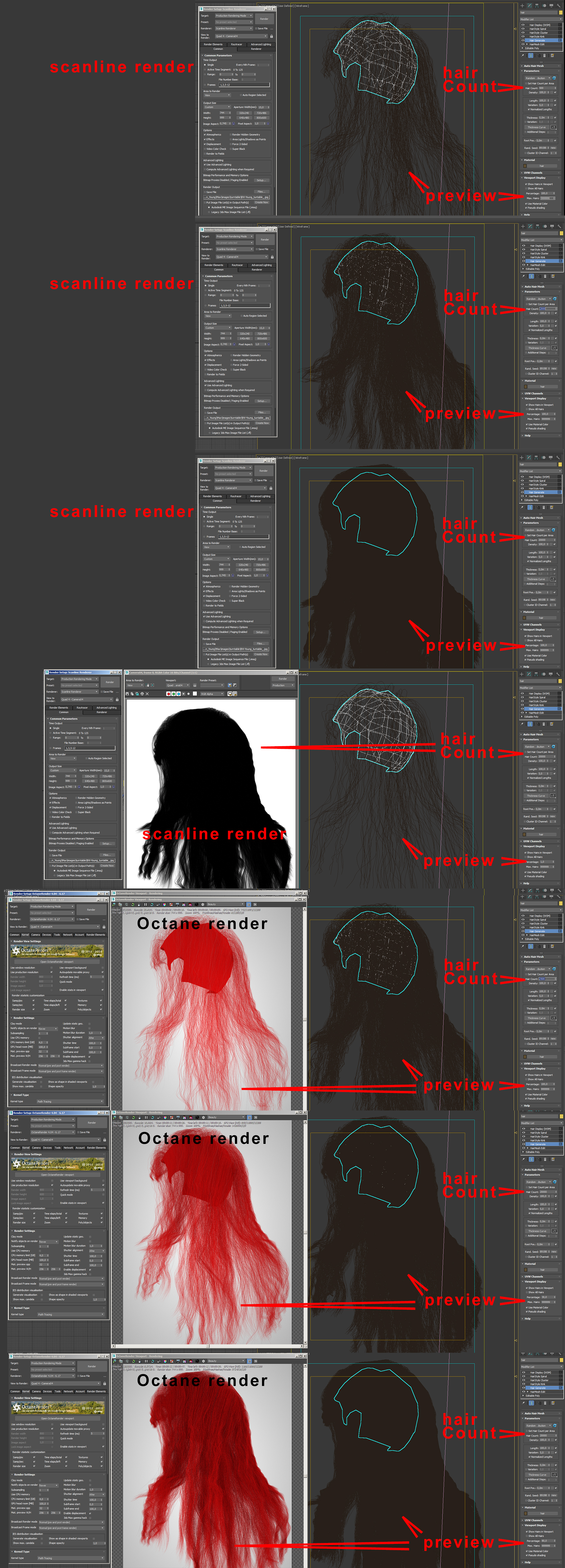

Hi stir,
I tried doing tests using scanline, these my findings:
I think the problem using Octane, it's just about the "viewport Display" feedback.
as you can see, the 99999 limit does not depend on Octane, it works as in scanline render.
the only issue (it seems to me) is that Octane does not follow hair count in parameters panel but the settings in viewport Display panel.
these are my two cents. what do you think about it?

Yes - I think we are saying the same thing
Octane is rendering what it sees in the viewport (preview)
And that is not ideal - When i am grooming a animal with fur, i will need a high haircount. probably more then 3ds max can show in the viewport. how do i workaround that?
