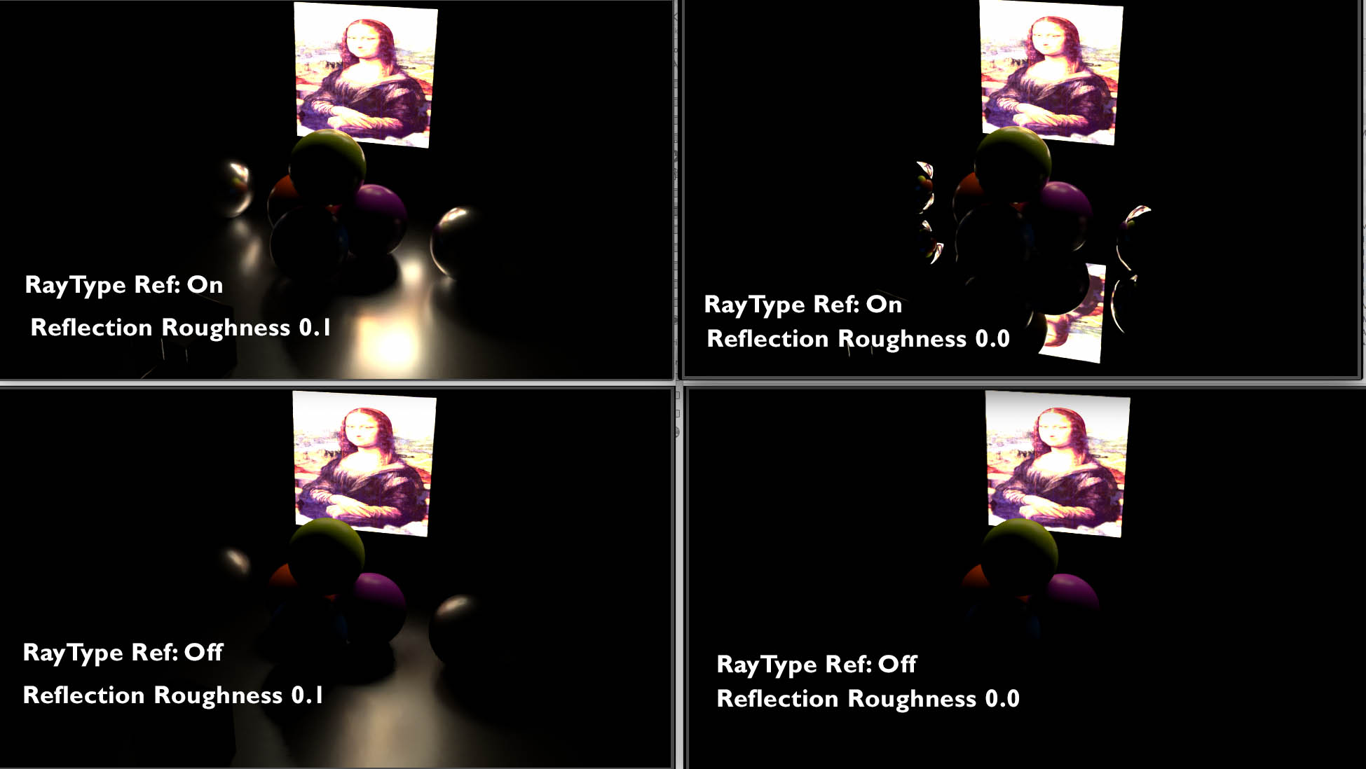

HHbomb wrote:After testing, diffuse material with an emission map can't be removed from reflections... It would be cool though. :(
I don't know if this is the same issue, as I'm using it in C4D, but what I'm seeing is that it will remove reflections of an emitting surface, but not the specular highlight. Depending on the reflective surface settings, it can look similar.

HHbomb
Posts: 1428
OOOOpps, sorry... If I don't want to see emission in reflections, I just need to uncheck "visible in specular" in emission map. :lol:
