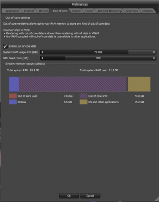

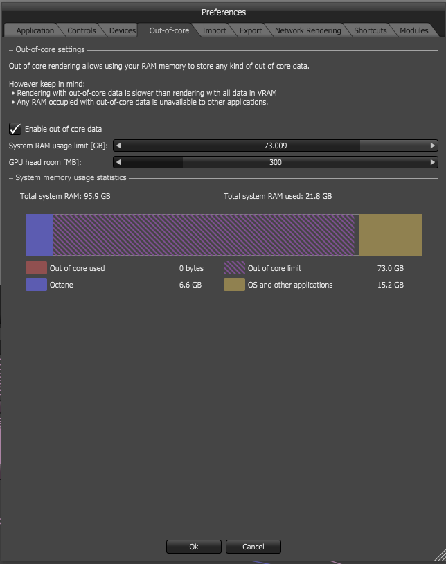

Well i've tried in Standalone right now and as you can see in the attachment, it could go higher in standalone.
It would still be nice to be able to go higher inside Cinema 4D, always exporting the scenes, which are huge sometimes, doesnt seem like a streamlined process
PS.: Seeing the attachmend image i am reminded that we installed some of the RAM elsewhere so sorry, i currently have 96 GB of RAM not 128GB...
