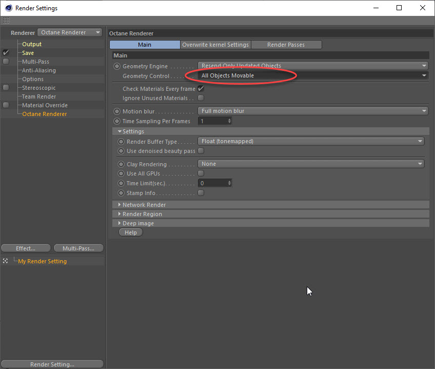

Btw be sure you have "All movable". So it should be same as LV. And be aware of triangle count differences between LV and PV for some objects, like subdivision or some generator objects. Other than this hard to know more without you send a better visual data.

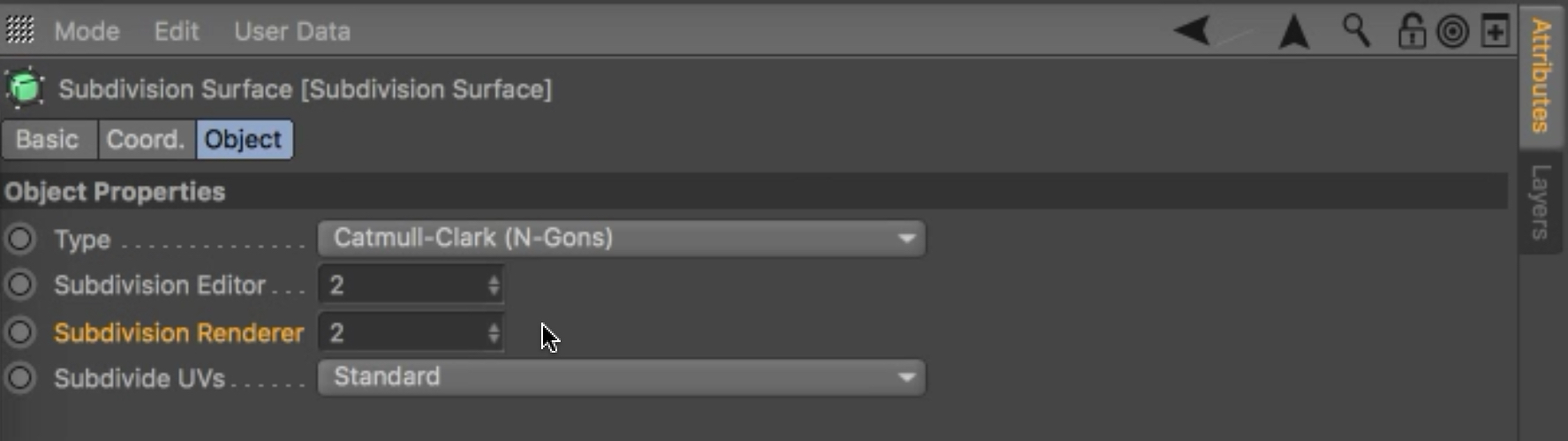

try to set the same subdivision for viewport and final render, for all the c4d objects with a similar setting:

As me and Beppe said, you should have similar data usage for LV vs. PV. But note that what Beppe said and be sure "All movable" selected. Otherwise engine reacts different on PV.

So many thanks aoktar and Bepeg4d, I finally managed to have similar results between LV and PV,
I started looking at the triangles increase in the Graphic cards monitor and they were indeed doubling up between LV and PV,
after a long research I found the assassin, it was a deeply nested cloner with an Hypernurbs object that was set to double up the subdivisions in render mode .

bepeg4d wrote:Hi,
ciao Beppe
that was the issue Thanks Beppe
