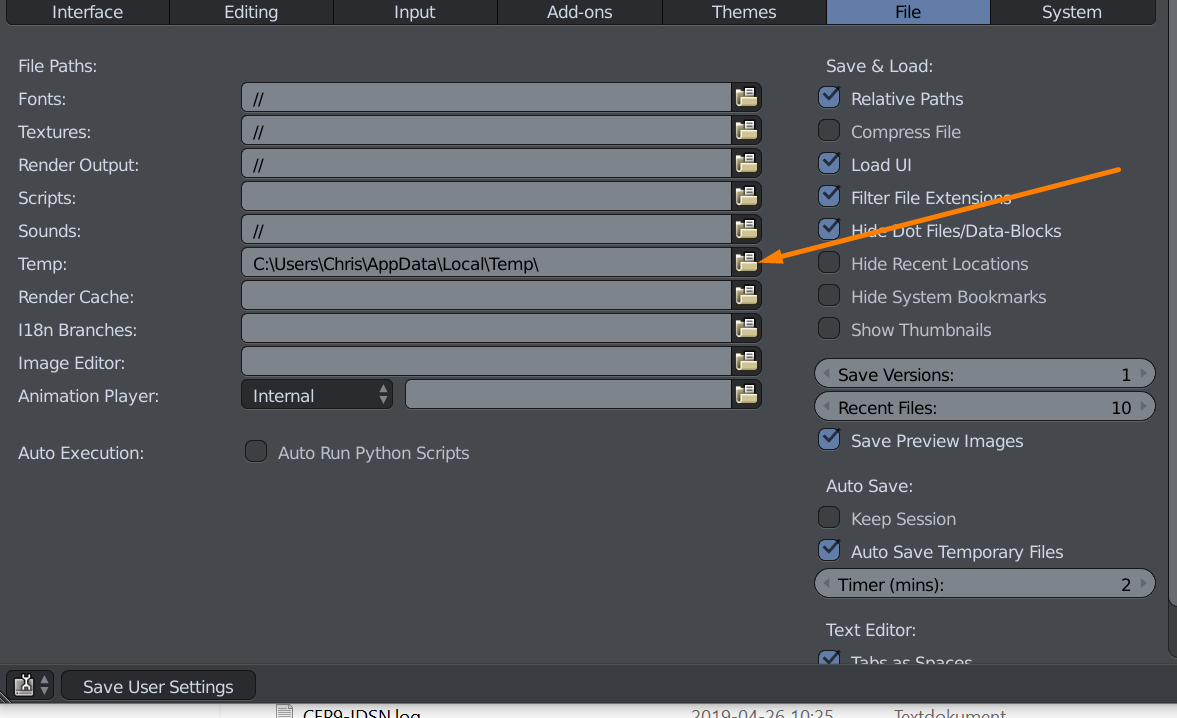

You're right, I was mistaken, I'm sorry.
Reading the "Release notes" again it seems that it uses Blenders Temp directory (under File in User Preferences).
This seems to be corroborated by the fact that there's an "alembic_export.orbx" file in that directory after I exported an ORBX.

Confirmed, just as reported in the Release note.ChrisH wrote:You're right, I was mistaken, I'm sorry.
There is still no option to disable this. Other plugins and standalone have this possibility.
