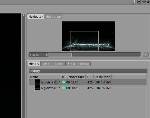

Rendering XParticles, simple scene, a few polygonal objects, one material....
2x 1080ti - 3m 03s
1x 780 - just 26 seconds !!!

of course, 780 is used on motherboard direct, for display... and 1080ti cards through risers.
But.
No more situations like that. Speed of 1080tis over polygonal scenes is much higher than single 780, as it should be.
Issue is just with particles render. What the... ))))
May be anyone knows what to do? )

Please use GPU-Z for monitoring the sensors of the GPUs while rendering:
https://www.techpowerup.com/gpuz/
In particular, check Temperature, GPU Load, and Power Consumption values.
ciao Beppe

Hello, bepeg4dbepeg4d wrote:Please use GPU-Z for monitoring the sensors of the GPUs while rendering:
ciao Beppe
I'll do check with GPU Z in a few days, but the issue of speed loosing is appearing on 2 (two) different PC machines.
The logic of particles render issue the same:
onboard.GPU=fast
through.riserGPU=slow
Ah ok, everything is clear now.
During animation rendering, it is necessary to update a lot of data frame by frame, so slow raisers are a bottleneck, especially with particles rendering.
Slow raisers are good only for static rendering, since after scene loading, GPUs are fast like "onboard" GPUs.
ciao Beppe

Thank you for the answer, but I can't agree with you because of example scene I meant in this topic is a single frame static rendering. Not animation.bepeg4d wrote:Ah ok, everything is clear now.
ciao Beppe
I've just tried to render another scene. Static, one shot.
No XParticles, but with octanescatter object.
1st render was with 1080ti+1080ti+1080 (risers) - time 1m10s
2nd render was with single 780 (direct onboard) - time 1m30s
3rd render was with single 1080ti (riser) - time 1m51s
It's new for me. I'm frustrated....
