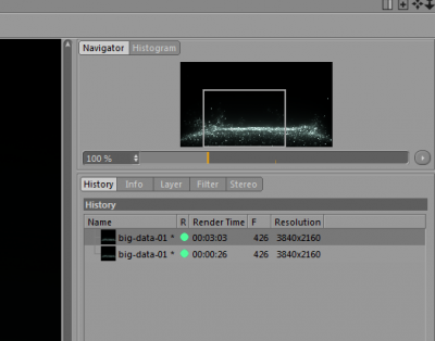

Rendering XParticles, simple scene, a few polygonal objects, one material....
2x 1080ti - 3m 03s
1x 780 - just 26 seconds !!!
sounds like a joke
of course, 780 is used on motherboard direct, for display... and 1080ti cards through risers.
But.
No more situations like that. Speed of 1080tis over polygonal scenes is much higher than single 780, as it should be.
Issue is just with particles render. What the... ))))
May be anyone knows what to do? )
1st - 2x1080ti<br />2nd - 1x780
1st - 2x1080ti
2nd - 1x780

Hello, bepeg4d
I'll do check with GPU Z in a few days, but the issue of speed loosing is appearing on 2 (two) different PC machines.
The logic of particles render issue the same:
onboard.GPU=fast
through.riserGPU=slow
Posts: 10585
Ah ok, everything is clear now.
During animation rendering, it is necessary to update a lot of data frame by frame, so slow raisers are a bottleneck, especially with particles rendering.
Slow raisers are good only for static rendering, since after scene loading, GPUs are fast like "onboard" GPUs.
ciao Beppe

Thank you for the answer, but I can't agree with you because of example scene I meant in this topic is a single frame static rendering. Not animation.
