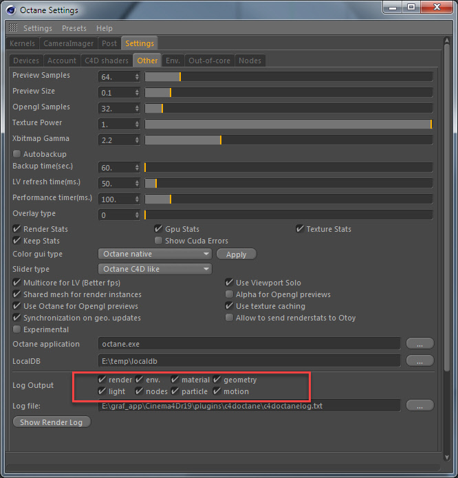

Have you activated these log flags? Disable all and try again.
It's working if I disable all the log output options! If I enable that again the problem is back

There maybe a null pointer access or so! Keep them disabled if you don't need report any problems. Also please send me c4doctanelog.txt and bugreport.zip as soon as hit NE drop crash. I'll take a look.DKFT wrote:It's working if I disable all the log output options! If I enable that again the problem is back
