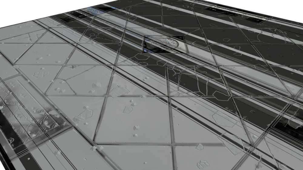

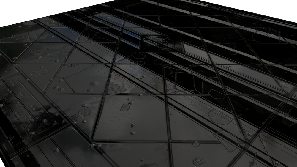

I downloaded this sbsar file from the SubstanceShare website and added it to a ground plane in modo: Modo's render looks correct: The octane render looks ok until the normal and basecolour outputs are added. I've added the outputs one at a time:
AO AO + Height AO + Height + Spec / Metal AO + Height + Spec / Metal + Rough AO + Height + Spec / Metal + Rough + Normal AO + Height + Spec / Metal + Rough + Normal + Basecolour The Normal and Basecolour outputs aren't mapping correctly. I've had the same issue with most of the materials from SubstanceShare, although a couple look fine.
