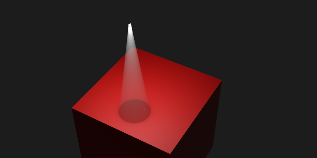

Here's my solution(s) for Volumetric spot lights in Octane Blender.
The first one (left) is my preferred way, by using an image texture for the Distribution of the Emission node. By scaling that object in (local) X+Y you can control the size of the cone (the object it self is pretty small). And then a cone with a volume.
In this case I rigged it up so you can match the size of the light circle together with the size of the cone, it's not perfect (since the relationship between the sizes isn't linear, and also depends on the distance to the surface), and it might be easier to control it separately (by turning off the Constraint on the light source).
The second one (right) is basically the same as the Volumetric Spot Light in SA (w/o the barn doors). I added a "gobo"/"hat", just to be able to control the spill.
The Second one has some problems (which it obliviously shares with the Volumetric Spot Light: See render from SA below). Firstly it creates way too much spill (IMHO), without any barn doors/flags/etc (and the barn doors limits it to a square shape, which isn't always (rarely?) desirable (from a spot light). Secondly the volume cone creates an shadow, which doesn't look natural (for most spotlights, that should be the brightest point...). If you create it yourself (aren't using the Volumetric Spot Light), you can control it by turning of Shadow visibility for that object (but that doesn't help if the cone "goes through" the surface it's shining on).
The plus side is that you get a visible light source (good for some scenes, like in the example, on the other hand you could fake that with the other method..) For the first method you have no spill. It does have the same problem where the cone creates an shadow (unless you turn of "Shadow visibility"), but since you can control the light itself so it matches the cone (and it's shadow) it isn't noticeable. The negative aspect is maybe that the light source/mesh itself is really tiny (similar to spot lights in "Blender Render"), but you can get around that by adding a bigger light/mesh only for that effect (but not a problem if the "source" isn't visible/outside of the frame).
That's just my 2 cents..
- Attachments
- OctaneVolSpot.blend
- (807.55 KiB) Downloaded 803 times
