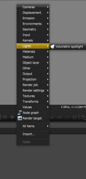

Yes I am talking about the new Spectron /Procedural Volumetric object available from the Lights menu in Octane stand alone 2018.1 (see screen shot). Both Octane stand alone and Octane Blender 2018.1 are stable releases so shouldn't they have the same features?
FYI - if an ORBX from stand alone is exported with such a light it appears fine when rendered in Octane Blender as an ORB Proxy. But I can see no way directly within Octane Blender to add this new Spectron Light object?

pegot wrote:Yes I am talking about the new Spectron /Procedural Volumetric object available from the Lights menu in Octane stand alone 2018.1 (see screen shot). Both Octane stand alone and Octane Blender 2018.1 are stable releases so shouldn't they have the same features?
I guess you don't need that complex setup after all (I totally missed that node, because I thought it was an script setup for the demo file). ;)
The Volumetric Spotlight looks to be a bit "special", as far as Octane nodes goes.. In 2018.1 it has the node type "Unknown", in 2019.1 XB1 it is an "Built in Node graph", that (plus the script from the demo file, and some other things) leads me to think it's basically a (compiled!?) script in disguise.
Whether or not this should affect if we can use that node in BO is another question, IMHO it shouldn't...
That leads to your question about whether they should have the same features, and you would think that they should. Well at least to a certain point.
Octane uses a "global node system", where everything, including objects/meshes, is nodes and the node tree your working with is basically your whole scene/project. In Blender we (mainly) just work with nodes just for materials, this leads to some awkward ways to handle certain things, like Vectron:
In SA you basically put your Vectron node into your Render target Geometry input (maybe via a geometry group or w.e.), in BO you have to add the Vectron node in a material, use an "placeholder" object and then, in the mesh settings, select that material and then the vectron node you want to use.
As for getting the Volumetric Spotlight in BO, looking at the result in the render (and the Lua script) it actually seems like it's just setting up a couple of meshes (the barn doors, an emitter and a cone with a volumetric medium), you could easily just do that with normal objects in Blender, the downside being that it's a bit more work and you don't get an "easy" interface to control it. :)

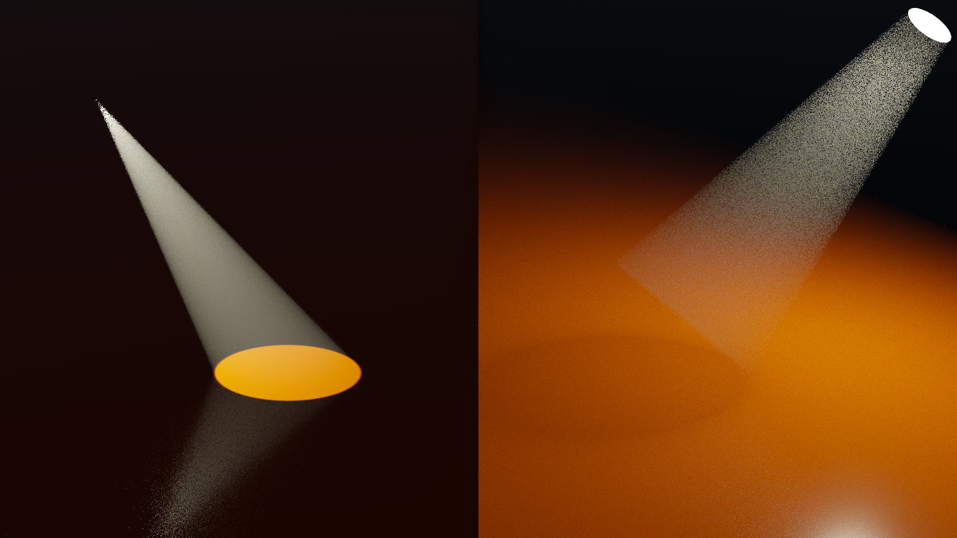

Here's my solution(s) for Volumetric spot lights in Octane Blender.
The first one (left) is my preferred way, by using an image texture for the Distribution of the Emission node. By scaling that object in (local) X+Y you can control the size of the cone (the object it self is pretty small). And then a cone with a volume.
In this case I rigged it up so you can match the size of the light circle together with the size of the cone, it's not perfect (since the relationship between the sizes isn't linear, and also depends on the distance to the surface), and it might be easier to control it separately (by turning off the Constraint on the light source).
The second one (right) is basically the same as the Volumetric Spot Light in SA (w/o the barn doors). I added a "gobo"/"hat", just to be able to control the spill.
The Second one has some problems (which it obliviously shares with the Volumetric Spot Light: See render from SA below). Firstly it creates way too much spill (IMHO), without any barn doors/flags/etc (and the barn doors limits it to a square shape, which isn't always (rarely?) desirable (from a spot light). Secondly the volume cone creates an shadow, which doesn't look natural (for most spotlights, that should be the brightest point...). If you create it yourself (aren't using the Volumetric Spot Light), you can control it by turning of Shadow visibility for that object (but that doesn't help if the cone "goes through" the surface it's shining on).
The plus side is that you get a visible light source (good for some scenes, like in the example, on the other hand you could fake that with the other method..)
For the first method you have no spill. It does have the same problem where the cone creates an shadow (unless you turn of "Shadow visibility"), but since you can control the light itself so it matches the cone (and it's shadow) it isn't noticeable. The negative aspect is maybe that the light source/mesh itself is really tiny (similar to spot lights in "Blender Render"), but you can get around that by adding a bigger light/mesh only for that effect (but not a problem if the "source" isn't visible/outside of the frame).
That's just my 2 cents.. :)
