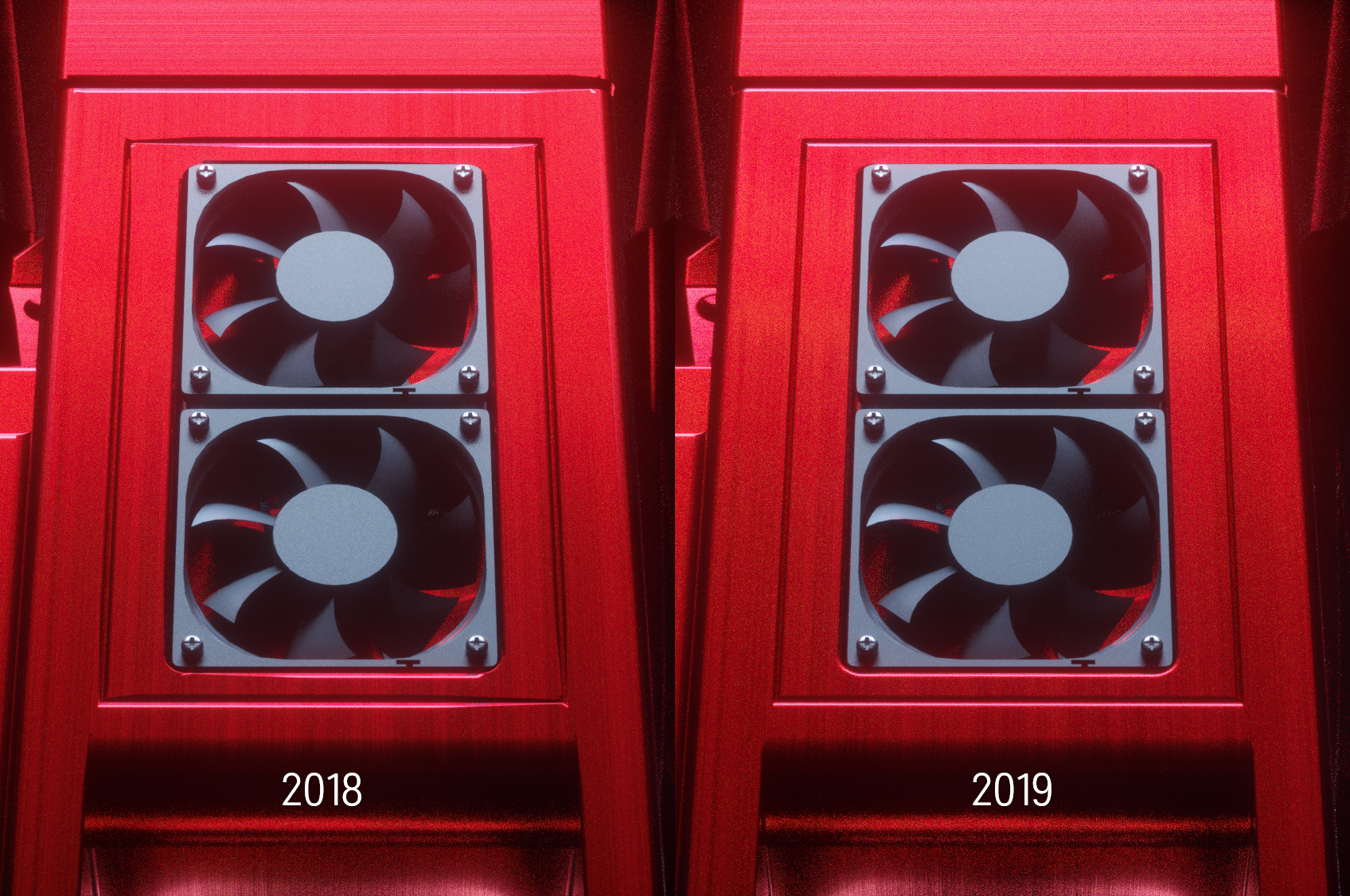

New round edges looks pretty good. Good work guys.
