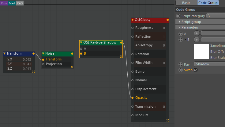

Just clarify some things for me, please:
1. On your first point, are you actually using the surface as a gobo, or just saying it can be done?
2. Is the method specific to OSL/C4D (the node setup is a C4D screenshot, right?)
3. Would you mind describing the lighting and surface setup?
Thanks in advance.
milanm
Posts: 261
Joined: Tue Apr 30, 2013 7:23 pm
1. Yup, the surface of the water in that gif does have a texture in opacity just like the one from linograndiotoy.
2. It's just a node. Works everywhere where Octane is integrated (even in other engines that support OSL) The shader is from here.
3. It's just a daylight/sun. The water itself is casting shadows in the shape of the noise texture.

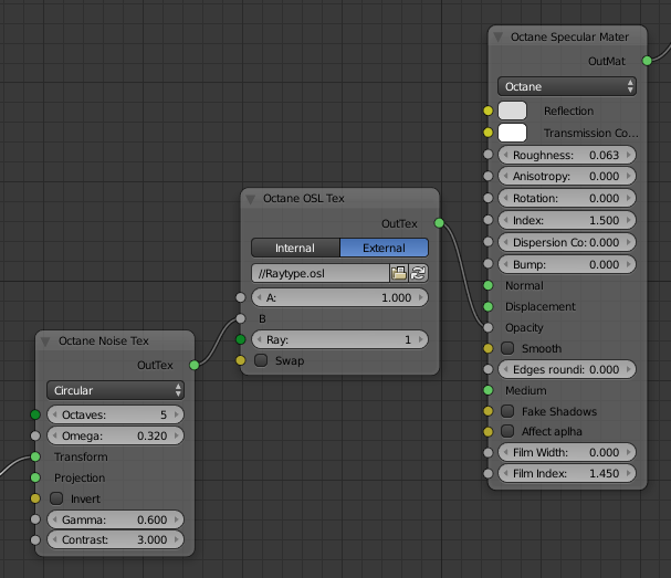

Here's how that might work in Blender.
It looks like the UI menu is replaced with integer numbers in the demo I'm using, If this is the same in the latest version you should complain to the plugin developer about that. The OSL script will work just fine regardless of UI and these are the settings I used:
Just for reference, the Ray input options are:
0 - Camera
1 - Shadow
2 - AO
3 - Diffuse
4 - Reflection
5 - Refraction
And it looks like the checkbox input is inverted compared to Standalone.
0 - Camera
1 - Shadow
2 - AO
3 - Diffuse
4 - Reflection
5 - Refraction
Water is animated so I didn't post an orbx example as usual--it would be huge. I'll see if I can reduce it to a single frame and post.

So, in layman's terms - because I know nothing about OSL/gobos/life in general - the following is happening:
Sunlight is being projected at a plane. The plane has holes in it in the shape of the noise pattern as it is plugged into opacity, therefore light hits the bottom of the pool in the desired pattern. How does the raytype node help?
milanm
Posts: 261
Yup that's correct.
Raytype just makes sure that the surface of the water doesn't look like Swiss cheese. ;)
