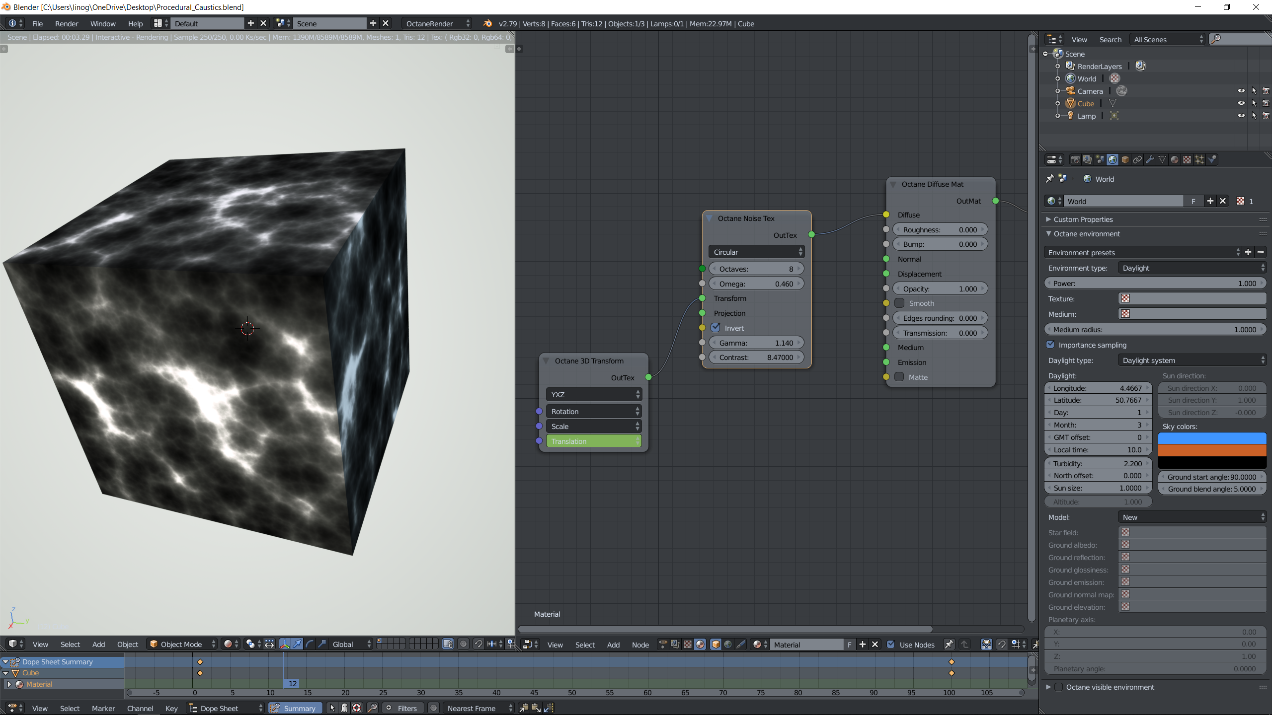

linograndiotoy
Posts: 1559
I would totally use an animated Octane Procedural texture to simulate this.
I included the scene i made. Turn on the preview and hit play.
You can use this as a mask so you can add animated caustics where needed.
I hope this helps.
Procedural_Caustics.blend
(541.09 KiB) Downloaded 431 times
