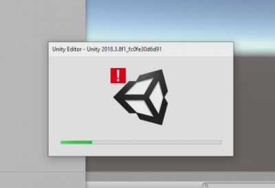

I appreciate the help and I attempted what you suggested. However, I still get an error followed by a crash. I attached a screenshot of what I see and then the next thing is Unity crashing. Using Unity 2018.3.8. I might try to download an earlier version to see if it works.

I didn't, I'm starting to suspect that the problem is running from a VM. I've been using Shadow with a dedicated P5000 and have noticed issues with another application as well. I cancelled the service and will try OctaneRender again after I do a new build with an NVidia GPU. Thanks.
